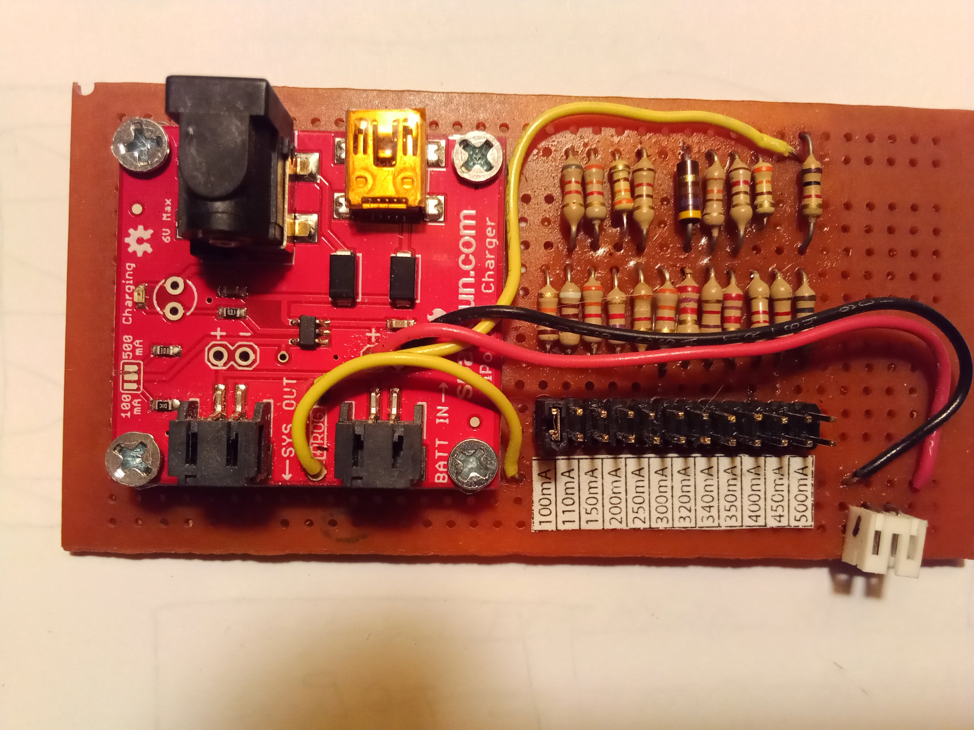

Yep. I blew it. Connected my battery to the on board connector instead of of my reverse polarity connector on the right.
Is there anything I might do to prevent this in the future or perhaps I could buy a different charger.

Normally you would try to make sure the connectors are physically different. If the ones on the board aren't used, remove them or fill them with silicone sealant.

They are JST connectors, and there seems to be no standard as to their polarity. Perhaps the addition of some kind of wrong polarity protection might do.
I wonder if a couple of diodes on the negative terminal would offer some protection.
In any event, I need to replace it with something or the same thing.
If you know of anything, please suggest.
I'd change all connectors to one standard, polarised type - eg. XC30 for something small like that.
If you cannot change the connection on whatever the battery is used with, use a short JST cable to an XC30 plug and leave that connected to the device.
(You cannot add diodes without messing up the charge voltage, on a fixed voltage charger. It would need an electronic sense circuit and relay, or something similar).

Thanks. Since for right now and all of my batteries are the same polarity, when I get my new charger, I will tape off the system board sockets.

You could protect the circuitry with a diode connected reverse polarity from the + conductor to to ground, and a fuse in series with the + connector. A reverse polarity input would blow the fuse (which needs to be sized for current and speed). Shouldn't be too difficult to calculate.
