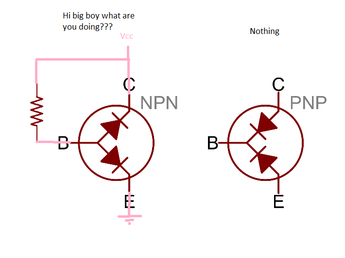

On the very first post, the OP requesting help wrote this particular sentence:
"Simple words because I am just a hobbyist. Thank you!"
Which apparently fell on deaf ears to a pedantic writer in this thread. His stubborn adherence to minutiae and his emphasis on a no-holds-barred discussion, while probably correct, has scared the hobbyist away.

Evidently you did not read my post #5 where I did answer the OP's question simply and directly. He must have been satisfied, because he did not ask any more questions about what I said. The rest of my posts were addressed to other members participating in this thread, and the OP was under no obligation to read them or participate. Could you be a little more specific and name the words that were not "simple". By the way, I am just a hobbyist myself.
