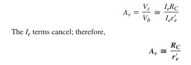

I don't think that the book is correct. The output is inverted therefore there should be a minus sign to show that inversion for the amplification. As the voltage across transistor drops/rises, there is an equivalent rise/drop, respectively, in voltage across R_C. Hence, Vc=-(Ic*Rc).
Also, I do believe that it should have been "Vin" instead "Vs".

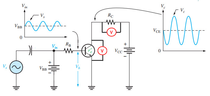

I think I do understand the equations. In Question #2, you have Vin=Vs+V_BB. Actually Vs is riding on top of DC supply V_BB.
Question #1:
bjt_amp_11-jpg.115847
As the input signal, Vin, increases, so does Vb , and Vc is an inverted output. Av=-Vc/Vb=-(Ie*R_C)/(Ie*r'_e)

Hi again,
I thought that I should confirm this with you. From our previous discussion, it was said and concluded that both voltmeters, ckt_bjt111, would read the same, right? Thanks!

The sum of the voltages across the transistor and Rc equals Vcc. Therefore, if the voltage is large across the transistor, it is small across Rc and vice-versa. That makes the amplitude of the voltages unequal.

Please have a look on this attachment, bjt_amp1a.
Question 1:
Shouldn't it be Vc = - (Ic*R_C)?
Question 2:
Shouldn't it be Vin instead of Vs?
Question 1: Nope. It's a positive voltage. Think of the voltage divider rule, with the transistor acting like the lower resistor.
Question 2: No because the book is talking about Vbe, which is the voltage drop between the base and the emitter.
