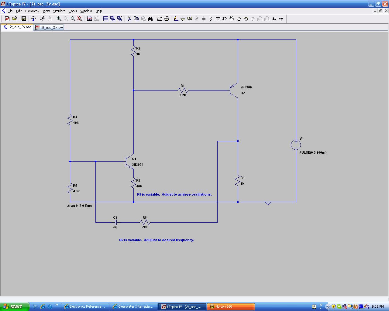

J Jony130 Active Member Feb 1, 2011 #1 Hi, can you suggest any simply diagram of a BJT astable generator, supply from 3V and capable to gen wave from range 500KHz to 2MHz.

ericgibbs Well-Known Member Most Helpful Member Feb 2, 2011 #4 hi, This is in LTS spice simulation. In an actual circuit layout would be critical Attachments 000esp04.gif 40.3 KB · Views: 244 000esp05.gif 42.2 KB · Views: 213

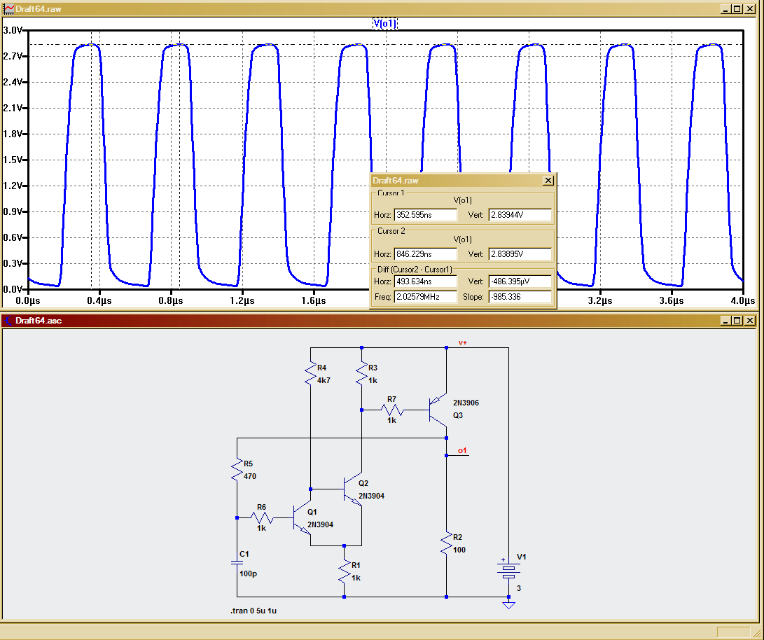

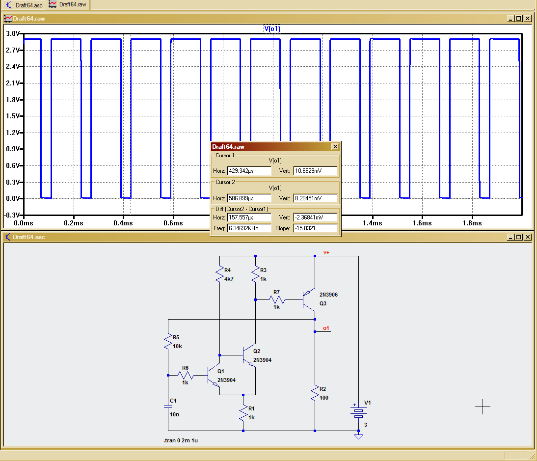

B BrownOut Banned Feb 22, 2011 #5 Hi Jony130. Here's a two transistor solution. It'll take a little fiddling with R8 to get it to work. EDIT: Here is the 3V version Attachments 2_tran_osc_3vv.JPG 87.7 KB · Views: 204 Last edited: Feb 23, 2011
