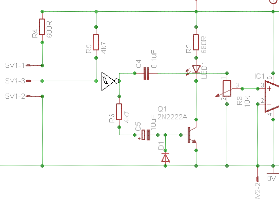

I have used a disc with holes drilled around the periphery as a pulley over which the line will travel. The disc travels between the faces of the optoisolator and the holes / no holes interrupt the optoisolator perfectly, the LED responds no matter what the speed of rotation is.
When the rotational speed is very slow the speaker fails to sound, it will only sound when the rotational speed increases. Are there any components I can fiddle with to perhaps improve the sensitivity of the circuit when the optoisolator is being interrupted slowly?

How slow is slow?
Try disconnecting R6 or C5 temporarily and see if you get better audio response at slow speeds.

1. Have tried both options (removed resistor and cap in various combinations) but neither appeared to have an appreciable difference. The speed is difficult to measure but if you interrupt the beam by moving an object slower than about 2mm per sec then she fails to make a sound.
2. Got me a speaker, 4Ω I know you said 8Ω but this is all I have to hand at present. Nice and loud but it stays on all the time and has an annoying growl. I can set the pot to a point where the speaker is quiet but the minute the beam is broken once the speaker stays on.
3. As the speaker was noisy thought I would keep on experimenting with the piezzo buzzer. Thought that perhaps the cap C1 on your schematic may not be needed with the piezzo buzzer so I bypassed it coonecting the buzzer directly to Pin 5 of the LM386 and ground. Progress, now it does not matter how slowly the wheel turns as every hole sounds the buzzer.
Whoah, two millimeters per second? So like it would take about 12 seconds to move an inch, right? Over a minute to move five inches? That's very VERY slow. Are you sure this is a disadvantage? Seems like that slow a motion wouldn't be a live fish on the line, might not even want it to make any noise.
Anyway, that's not a problem with the circuit, I just had no idea you wanted the motion that slow. What's happening is the rise time on the opto is too slow for the amp.
If you want to make it work at those super-slow speeds, you will need a comparator with hysteresis to speed up that signal. Fortunately, for this circuit it's an easy fix. Get one of these guys -
https://www.fairchildsemi.com/ds/CD/CD40106BC.pdf
And insert it like in this diagram. Give it +9V and ground on Vdd and Vss, respectively, and tie any of those unused inputs to ground. The 40106 will give a "snap action" response to slow moving signals, and it runs off anything up to 15V.
