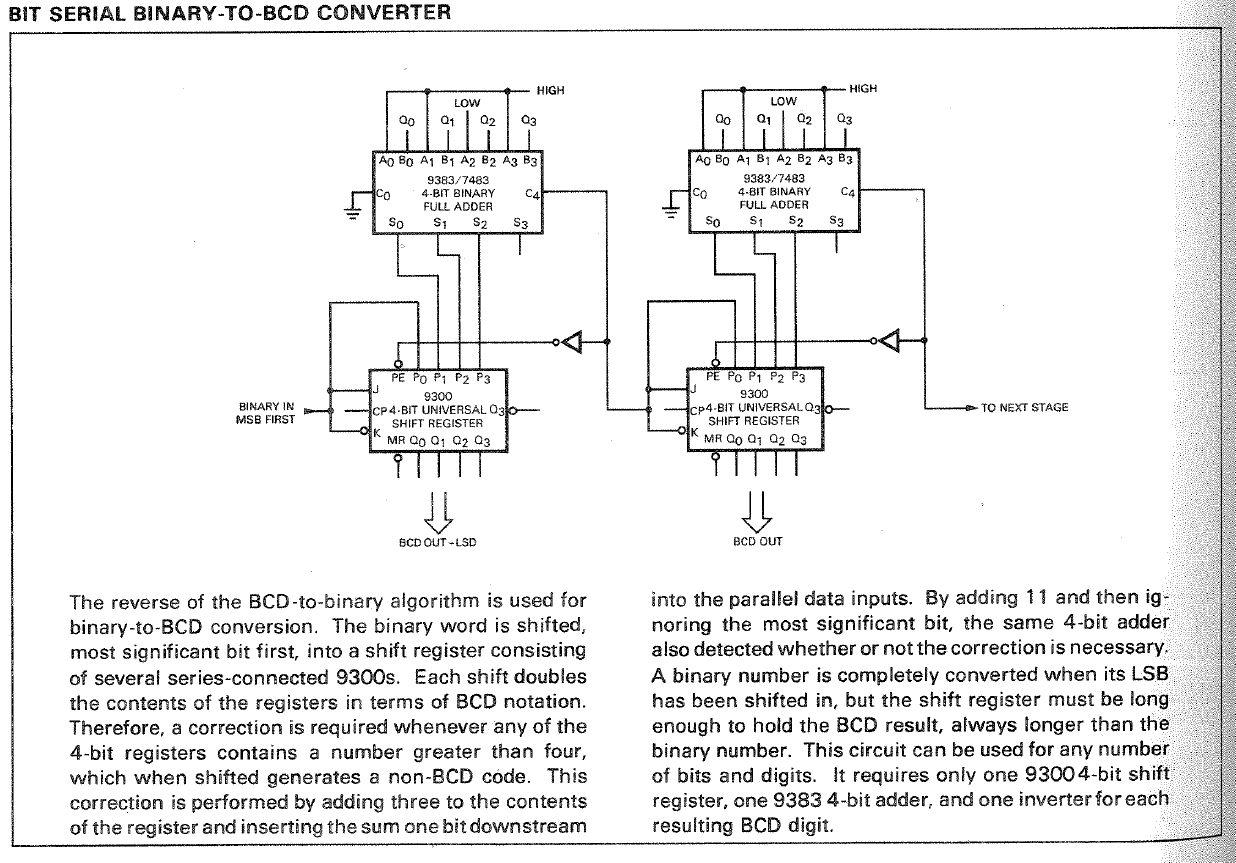

i have inputs in 4 bit binary ( from 0 to 15). i want to display my 4 bit binary inputs to 7 segment display which means i must have two 7 segment display. how can i convert my binary inputs to bcd in simplest way? can anyone give me explaination on how to make both of my 7 segment display the outputs of two digits ( from 00 to 15)?

It depends on what you mean by "simple".
You could use a PIC to do this with very simple hardware and software.
You could use a 74185 if you can find one.
You could use a 74LS154 and a bunch of diodes.
You could use a bunch of logic gates instead of above.
You could use a EPROM chip.

Yes, I mentioned the 74185 above, but it'll be hard to find. Maybe there is an easier way to do this. Post your existing circuit here.
the convertion of binary to BCD is just part of my digital electronic project actually. the project is 4 bit positive subtract calculator which the output must be display with 7 segment display. i built the circuit but i get stuck when the part i have to make connection between the the 4 bit binary output from full adder(7483) and BCD to 7 segment decoder(7447).
Here's a method to convert serial binary to BCD. It uses an adder and a shift-register per digit. Perhaps you can adapt it to your needs. It's from an old Fairchild TTL Applications Book.

on1aag said:
If you like industrial archeology here's another one.
No idea how it works though.
I simulated the circuit and it seems to work. The "Co" line at top left is the left "Tens" digit. It's high for 10 through 15 input.
The "1", "2", "4", and "8" output at top is the right BCD digit for 0 through 9.
This scheme only works for 4 bits but I believe that's all you need.
on1aag said:
Hi Cucumber,
No idea how it works though. :D
on1aag.
Interesting circuit.
It works by detecting any number greater than 9 ((8&4)|(8&2)) and using that as the 10s digit. It also feeds the 10s output into the 4 and 2 bits of the adder therefore adding 6 to any number greater than 9.

Hi Cucumber,
Connect the LSB to the "1" input at the bottom,
. . . and the MSB to the "8" input.
Connect the "1" output at the top to the A input
of the 7447, . . . and the "8" to the D input.
on1aag.

Hi Cucumber,
From 0000 to 1001 the circuit only passes the data from the
inputs to the outputs. Disconnect the output from the third
nand from the full adder and ground the pins of the full adder
with value "2" and "4" and repeat the test from 0000 to 1001.
Then check the outputs of the first two nands, one output
should be zero at 101X, the other should be zero at 110X, in
both cases the output of the third nand should be logical 1.
At 111X both nands connected to the inputs should be logical
0 and the third should be logical 1.
There's nothing wrong with the circuit, the problem lies with
the cucumber who is trying to duplicate it !
