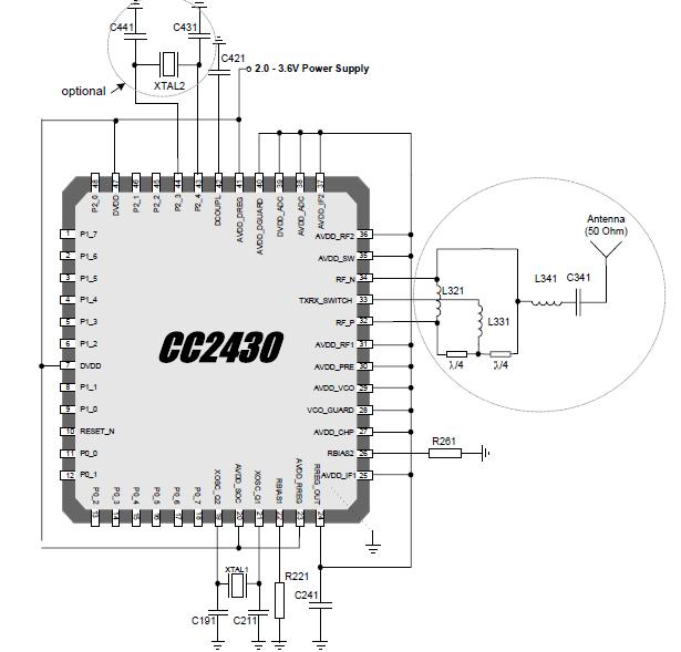

As you could guess, I cant post here the exact schematic becuase my company wouldnt allow me to do so.
The MCU is CC2430
Here is the crystals part of the schematics.
(The crystals are XTAL1, XTAL2).
I have measured the DC voltage of both pins and it was 1.8V in each pin of the two crystals.
I must add that the MCU has an internal 1.8V regulator (supplied by the 3.3V VDD PSU) that according to datasheet is supposed to supply the analog part of the MCU.
Does the analog part contain both crystal?
Meaning is it logical that the each crystal's pin receives 1.8V?
Thank you.

I've used plenty of watch crystals in my projects, they all work fine. You can't use a scope on them as it will load the circuit.
And of course you used the correct caps and recommended PCB layout with ground ring for the crystals.
Some of those watch crystals use 6.5pF load caps. Some probes are 10 to 15pF
Either way we don't know how the OP arrived at his conclusion about the frequency error.
PS the internal oscillator will use the digital supply. The datasheet will often recommend matching crystal types.

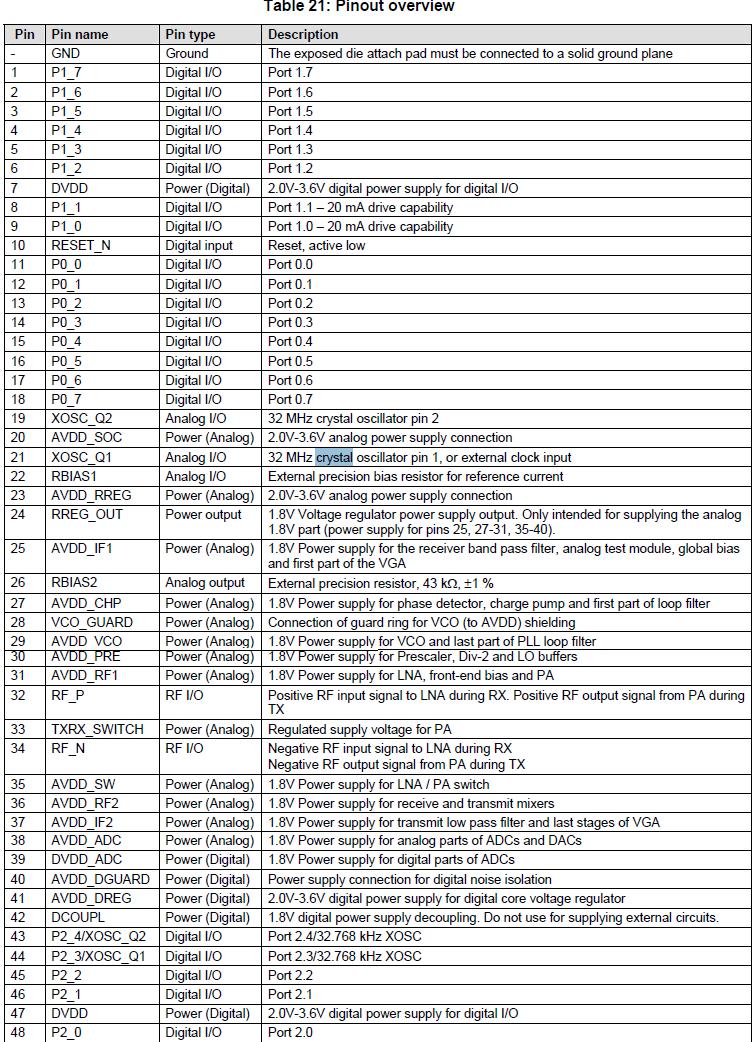

Moreover, could you please tell me by this table, what voltage is supplied to the crystals?
alphacat, you don't seem to understand how crystals work, they're not fed a steady voltage, they're used in the feedback loop of an amplifier. Have you tested the circuit boards or are you just assuming they're not going to work? What types of caps are you using on the finished boards and what were you using to test the setup before? I'm guessing it wasn't in a breadboard.

1. So when I measured the DC voltage on the crystal pins and received 1.8V, wasnt it a bias voltage? where did it came from if not from the XOSC_Q1, XOSC_Q2 pins of the MCU?
2. Yes I've testet both boards.
Both pilot's and prototype's MCU sections are the same, have the same components (same capacitors), the only different is the way that each trace goes from A to B, but it is the same A and the same B for each trace.
What could make both crystals not working? it seems something that bothers both of the crystal, do they have dependent on each other?
I'd appreciate it if you could refer '1' and '2' separately.
Thank you.
Does your finished PCB have a ground plane? Are your tracks between the MCU and the XTAL longer than 10mm? You may have excessive PCB capacitance.
And the way I measure XTAL freq is to program the MCU so it toggles an output at a divisor of the freq (like /256) then measure THAT freq with a freq meter (or a CRO). This allows the XTAL to work exactly as it would in normal operation, ie no CRO leads attached.
