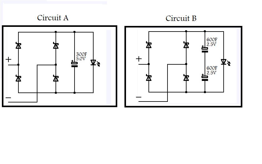

You tell me that I could put 2 of those 2.5V cap and basically make a 5V cap with them ? I wasn't sure if that was possible, since I know that capacitors in series is the same a resistor in parallel for the formula.
I attach an image for my question this time...
Basically, would that mean that those 2 circuits are the exact same, and so will behave the same way ?
Don't bother about the circuit, but only the caps... I just picked the first circuit I fell on.
If yes, it would probably be the easiest solution, however 40$US bucks for each cap is bit more I expected, so I'll have to check, because I don't want to sacrifice brightness for the cost either, but it's almost the cost of a good Dynamo lamp at that point :

So what about those circuit .. ? Circuit A = Circuit B .. ?

Also your right about the capacity change due to stacking. If you put two 2.5 volt 600F in series you will have the equivalent of a 5 volt 300F.
I am wondering about the super caps being used in series though. Being voltage sensitive if the capacitances are not exactly matched one will get over charged and burn out.
Those SuperCaps are not manufactured in China, but in Germany! Never heard about German precision work? :)

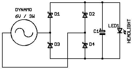

Meh I attach the wrong image. Here is the right one.
No matter how often you post that circuit it won't change to be utmost dangerous. There is no charge voltage limiting circuit for the caps
(If you're are planning on SuperCaps you have to take care not to exceed the maximum allowed charging voltage, otherwise SuperCaps can be considered bombs)
