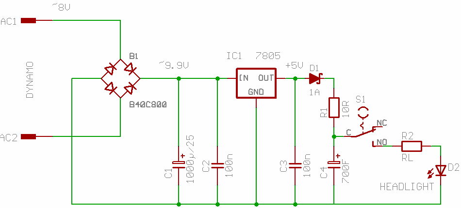

First here's a link of the circuit I wanna build for my dynamo LED light for my bicycle. It seems like a pretty good base to start, and also to optimize it - I'll probably start with something like this website shows :

The role of C1 ( 1000uF - 10000uF ) in this one is supposed to be only for making sure the light is constant according to the author on the website.
I was wondering however, if I replace that cap with a super cap, something like 1 Farad for example - would the cap act as a power buffer also ? Like - without modifying the circuit at all ?
This is for, when I stop completly, the light can stay on for couple of minutes ( that is after charging it a little while of course )
I found some cap for sell on ebay ... I guess I can link it ... :
Like you may have seen, those are 5.5V max ... my bottle dynamo on my bike is a 6V generator.
I thought it would still be okay, since with that circuit there's at least 1 diode in the way, dropping the voltage of about 0.7V - making it 5.3V or less - am I right ? So this wouldn't be a problem ?
Or does the fact that the dynamo is going faster on high speeds will get the voltage much higher and therefor needing more resistant components ? ( I didn't check the power output of it with a meter I gotta admit )
I was thinking of using a 3 X AA battery flashlight anyway - which is 4.5V if I'm not mistaken ( like linked above ).
Also - out of curiosity - if I just stack the 1 Farad cap, right in parallel with C1, would this increase the duration of the "power buffer" - therefor increasing the length time of lighting after stopping ? Or something bit more special needs to be done ?

You need a resistor in series with the LED.
even at 5.3 Volts it will fry a 3 Volt white LED.
If you bike fast the voltage will easily go up to 7 or 8 Volts.
Also with a LED the loading on the dynamo is less and may increase the voltage even further.
Try to keep you max LED current at about 20 mA for standard 5 mmØ LED's
By re-reading your post again I see that the output voltage of your bridge rectifier may be too high for your 1 Farad supercap.
These are rated at 5.5 Volts and that is the maximum voltage. Any more will damage the cap.
You need to measure the maximum voltage or, at least fit 1 or 2, 1N4001 diodes in series with the positive output too keep the bridge rectifier voltage below 5.5 Volts.
The original circuit uses the wimpy generator to limit the current to 0.5A for a high power LED that limits the voltage to about 5V.
Ordinary LEDs will blow up with 500mA and if a resistor is used to limit the current then the voltage from the generator will go very high when the bike goes fast.
A supercap might power an ordinary dim LED for 10 seconds with it dimming.

3AA cells are 4.5V only when they are new. Their voltage quickly drops to 3.6V. The white LEDs might be 3.0V and each one probably has its own current-limiting resistor.
But we don't know their voltage and we don't know how they are connected.
Also I'm gonna check the voltage output tonight, if and how much it increases when I'm going fast. I was wondering if it would be instead the max current capacity that would increase with a faster speed ?
I think both the voltage and current from the generator increase when you go fast. You must use a suitable load to measure the voltage and current.
If the voltage go too high, what would be the easiest way to diminish it so it stays always at 4.5V or so ? I guess there are some limiters ? ( I'd like to avoid using a power source chips for heatsink problem and all .. )
Use a low-dropout 5V linear voltage regulator IC. A diode in series with the output will reduce the voltage to 4.2V. The regulator might need a small heatsink.

If you take a close look at a factory built bicycle headlight (OSRAM, PHILIPS) you'll be amazed by the number of components.
Under no circumstances you must exceed the maximum allowable LED forward current.
Supercaps can be considered bombs if charged beyond their nominal voltage. WIMA manufactures supercaps with the capacitance of 500, 700 and 1,200F.
You could chose one of those and make sure that they won't be overcharged (voltage) using a regulator circuit.
Also you must take care that the cap won't discharge into the dynamo when it's not moving.
Refer to the schematic when planning your headlight circuit. For D1 use a Schottky-Diode capable of 1A current flow. It prevents discharging of the supercap into the voltage regulator.
R1 limits the charging current into the supercap. When it's uncharged it is like a dead short. As charging current decreases the voltage across the cap will reach 5V.

DVMs are designed to measure AC and DC. The AC-measurement will only be correct if measured at the frequency they are designed for (true RMS measurement). The dynamo has a much higher frequency and you can only read approximate voltage values. Don't forget to switch your meter to AC.
Boncuk
Oh wow ...
I didn't even know that dynamos were an AC source of power heh - it shows how much I know about them ugh ... I do read from 0 to 6V AC on my meter, and even more probably if I would have give it enough indeed "
I thought the bridge was to avoid problems, IF ever the wheel was turning the other side. I should have remember a diode bridge kinda means AC power errr
It's a bit odd though that they make it so that the "-" ( what I thought to be a ground ) is connected to the frame through the mounting device .. I'll have to remember to isolate the ground when I build that circuit, so it doesn't touch the frame at all.
Thanks for the nice tip and schema seriously, it is very helpful.

However I like it the more simple it can be ... I was looking at this one:
At the start, I was thinking making something similar, with maybe 1 more diode to avoid cap discharge and a resistance if needed, but this guy circuit seems to work fine ( according to him ), and he got pretty much nothing of all that.
Would it work if I do that ? ( Replacing the cap with a 600F )

Given the cost of a super cap and all the voltage limiting and what not needed you may very well be further ahead to wire it up with some small Ni Cad batteries.
All you would need is a diode and voltage regulator on the line coming from the generator and one diode in the line coming from the battery source.
When you are moving the generator output will be at a higher voltage than the batteries so it will supply the power however when you go slow or stop the batteries will take over.
a automatic battery charging circuit powered from the generator could be added if needed also.

This is using a 16V cap ( they are the only available on WIMA website - apart the 2.5V )
If I charge that cap ( 16V max ), with a constant 5V. Is the cap gonna stop as soon it reaches 5V too ? ( which would sound right to me ) - Therefore not been a problem for it to work, but reducing quiet a lot the duration of the discharge, since it will never be fully charge ?
Basically, I could just ask, how does a cap discharge Voltage is determined ?
The circuits you posted use a high power LED to clamp the voltage from the dynamo to 5V. The LED flashlight is not high power and it will not clamp the voltage. So the voltage from the dynamo will go as high as it can which might blow up the LEDs and the supercap.
A capacitor charges to the supply voltage.
The voltage of a discharging capacitor drops exponentially. The voltage drop is very fast at the beginning so you will see the LEDs dimming.

Thanks for the info, I didn't know about those power LEDs I shall check them out.
However I just realized in fact that the only available high capacity ( 100Farads or more let's say ) are 2.5V max.
I thought there were 16V, but these are normal low capacitor. The only one I could have enough "juice" in it would be in the 2.5V cap.
I'll have to figure this out, I wonder if I could get a good light with only 2V of power, even though I know some LEDs can work with that.
Maybe if I use cap for each LEDs I wanna light ? Or maybe if I boost the voltage ....

What's wrong using a SuperCap?
They're maintenance free, don't require a charging circuit like batteries and give a reasonable operating time for an LED. Calculate the time knowing that the capacitance of 1F means current flow of 1A for 1 second.
A SuperCap with 600F has these dimensions: lenght=48mm, width=26.5mm, height (including 6.3mm terminals for slip-on connectors) 87mm.
I contacted WIMA today to get a quote about SuperCaps. Will let you know where to purchase them and what they cost.
