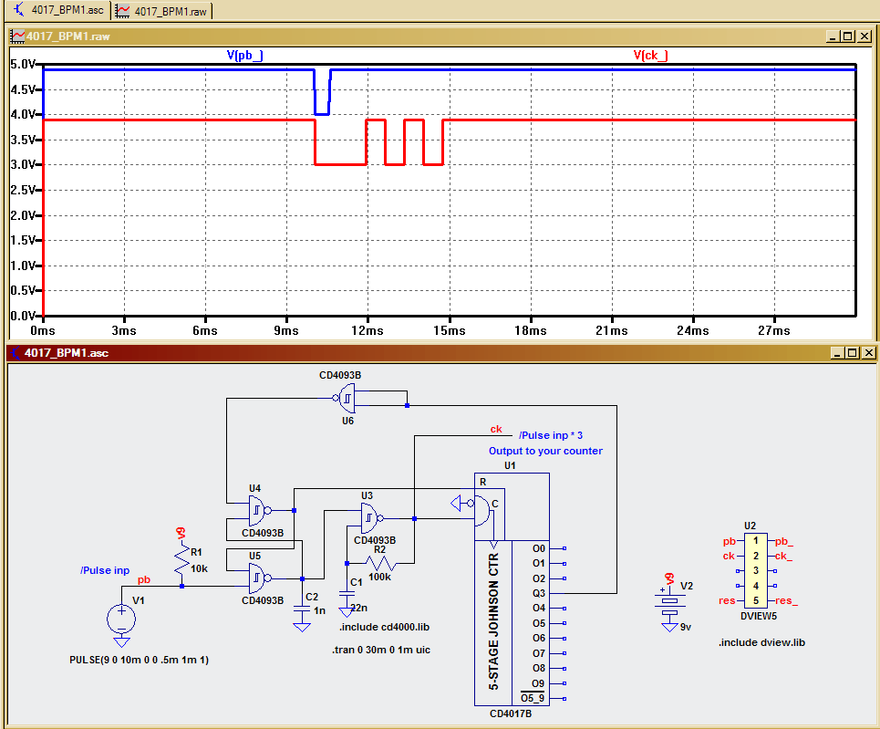

You can multiply the beats by three using this simple circuit.
This is set for a 3* 20 sec rate.

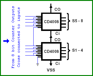

Hi again,
Here's the circuit i was talking about...requires 2 ic chips part CD4008. Propagation delay less than 245ns.
