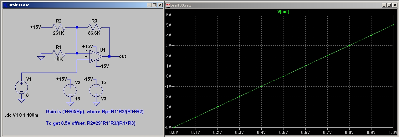

Hello All,
I am trying to design an op-amp circuit with the following specs and wonder if you guys have any recommendation of an op-amp that would perform better.
1) Supply voltage will be ±15V
2) Input voltage 0-1V Analog signal (not a video signal)
3) Bandwidth of the input signal <= 1KHz
4) Gain should be in the range of >=7 to <=11
5) Output offset adjustment so that 0.5V i/p = 0V o/p
6) Very low output noise
Any recommendations on which IC to use and a better design for better performance?
thanks

Here is a single-opamp circuit which has the required gain (~10) and offset (-0.5V). It has a very high input impedance for the DAC signal. Requires 1% resistors. It uses the +15V supply to generate the offset. Disadvantage is that the gain setting resistor R3 and the offset resistor R2 interact, so you will have to solve a system of two equations in two unknowns if you independently want a different gain or different offset.
Plot shows the output voltage vs the DAC signal.
Thanks for your schematic. The offset is always constant (i.e. 0.5V I/p ~ 0V o/p), once its fine tuned and as well as the gain too once its calibrated to the system. So, at first, can I try to use trimmers in place of R2 & R3 and fine tune them to get to the required specs and then replace them with 1% resistors?
Do you have any recommendation of a stable op-amp at these gains or any op-amp should be able to do this (like AD811/ LT1363/OPA827)?
