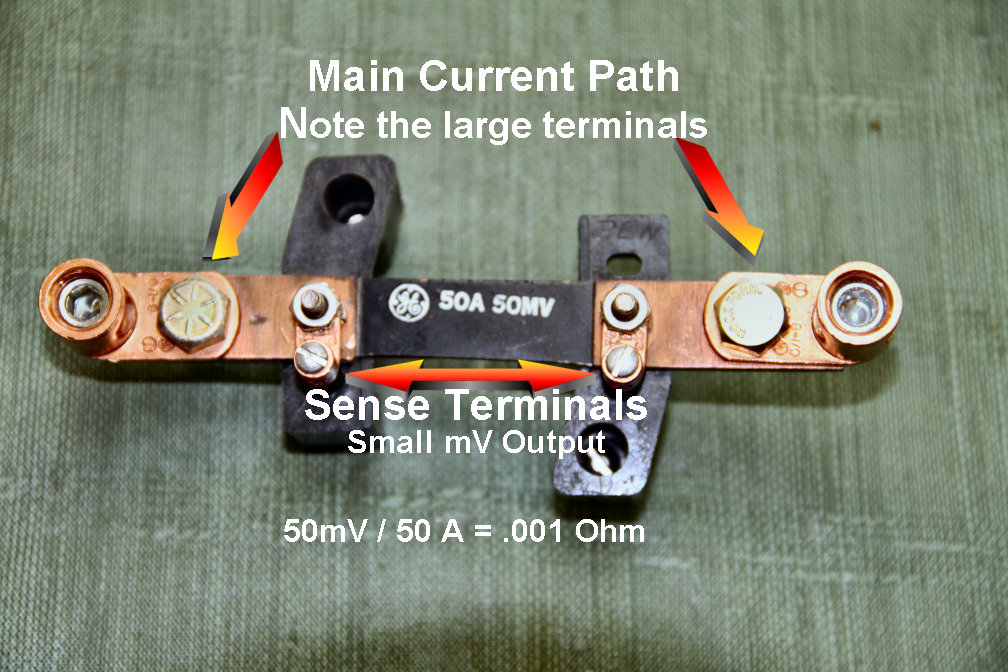

Attached is an image of a 50 Amp 50 mV shunt. Now as we have covered a current shunt like this is no more than a very low resistance, very high power resistor. The image tells us the actual resistance between the sense terminals should be about .001 Ohm. Sure as hell a low resistance huh? :)
Now, do you have a meter as in a small maybe hand held digital voltmeter that can measure milli-volts? Got a small piece of maybe AWG 12 solid conductor wire, as used in home wiring, like a chunk of ROMEX cable? Making a basic shunt to learn from is pretty easy. A very short length of copper wire in a large gauge like AWG 12 or 10, a meter and a few alligator clips is all you need.
Beyond that, any of the solutions recently linked to will work but making a small home brew shunt would maybe help the learning process.
Remember something. Earlier I asked if you ever plan to reverse polarity (motor direction). If you do it is important to place the shunt upstream from the load polarity switching. This is especially true when using an analog meter designed for unidirectional input.
