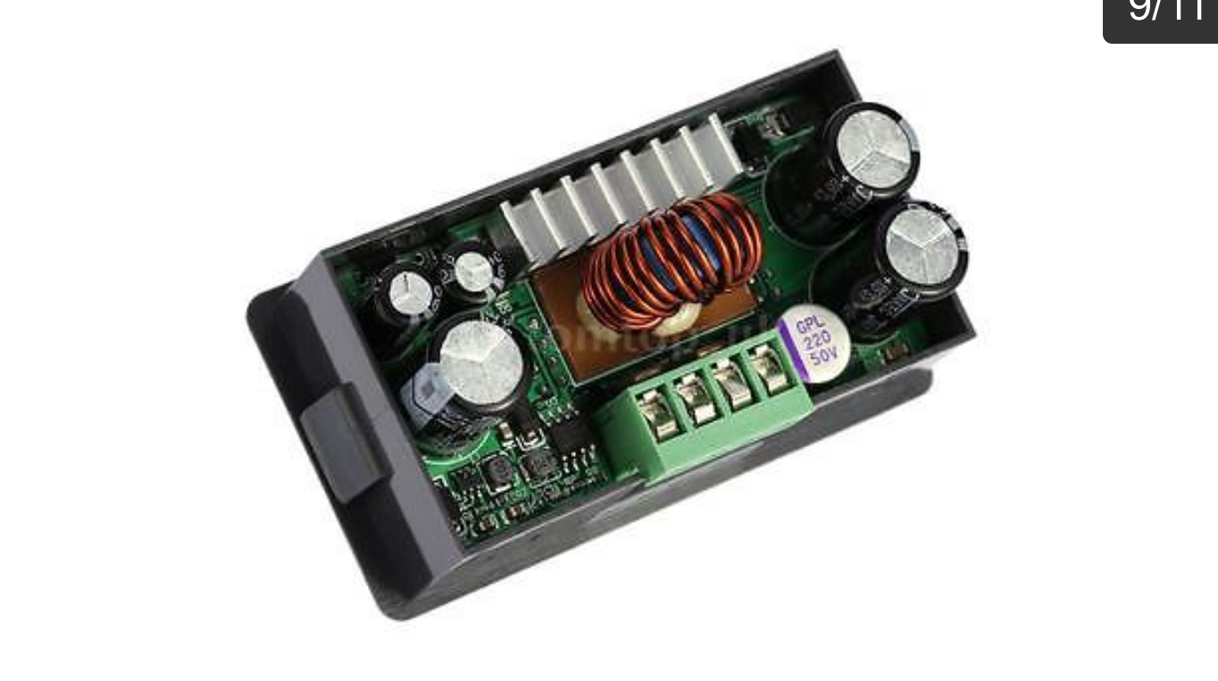

I'm not really awake and my eyes are blurry this morning, so I apologize if I'm too far off the topic here. If the power supplies still make DC, look at these modules on ebay. You will be amazed.
These come in a variety of voltage/amperage combinations. I recently got one of the 50 volts, 5 amp versions. Connect a DC source at up to the maximum voltage and any current rating. You then have a spot-on, extremely accurate power supply where you can set the voltage you want, the current you want, power limits. The the menu screen you can set absolute limits, so when you're adjusting any parameter with the rotary encoder, it won't let you exceed those limits.
The output voltage is what you set within the limits of my Fluke 45 to verify. If you want a constant current supply, set the current with the encoder and what the display says is exactly what you will get when you connect a load.
These come in up to 15 amp capabilities which use the same module and firmware with an external circuit board. The 2 amp modules seem to include a built-in thermostatically controlled fan; other versions you need to bring your own cooling for higher loads.
Some of them require use of an external rectifier to charge batteries (which means the voltage readout will be incorrect) While others don't. This feature is spelled out in the specs, so if you want to charge batteries, read carefully.
