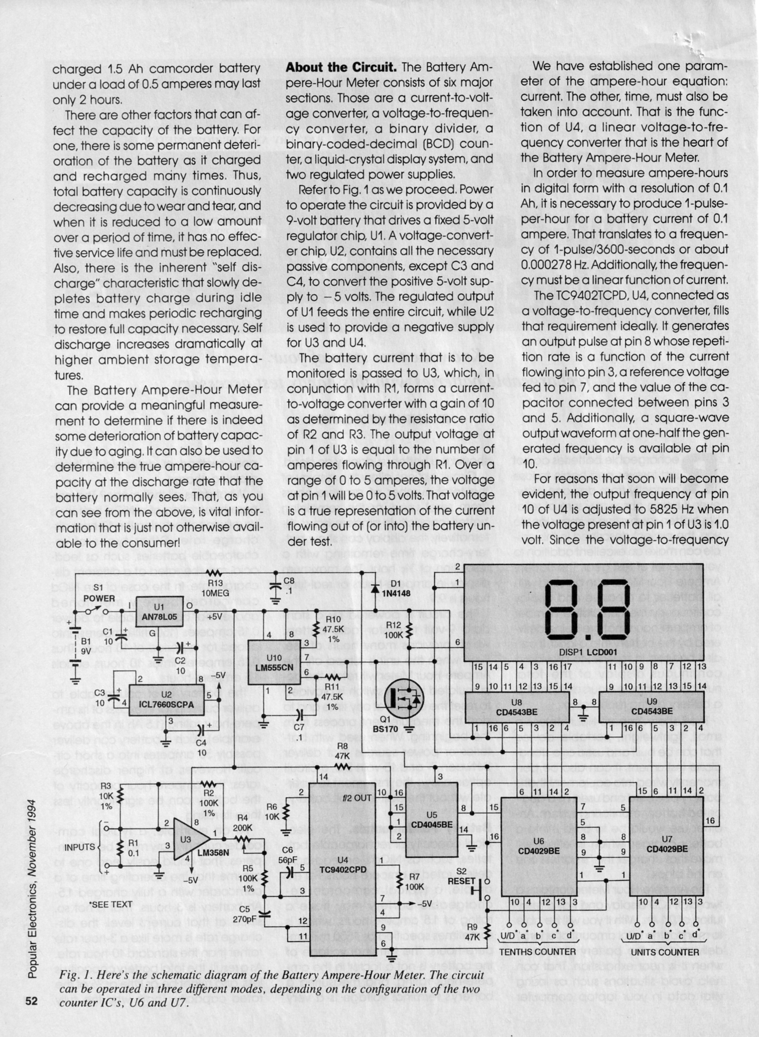

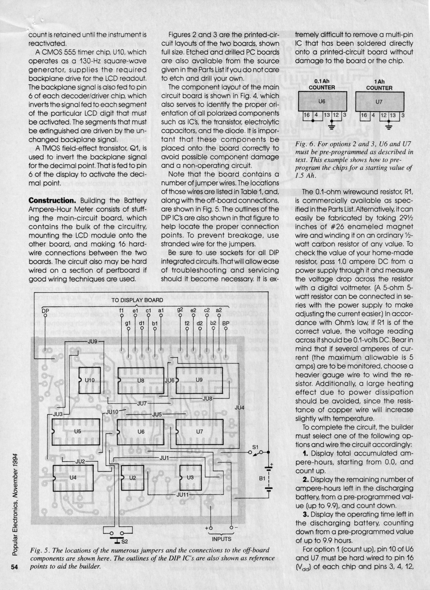

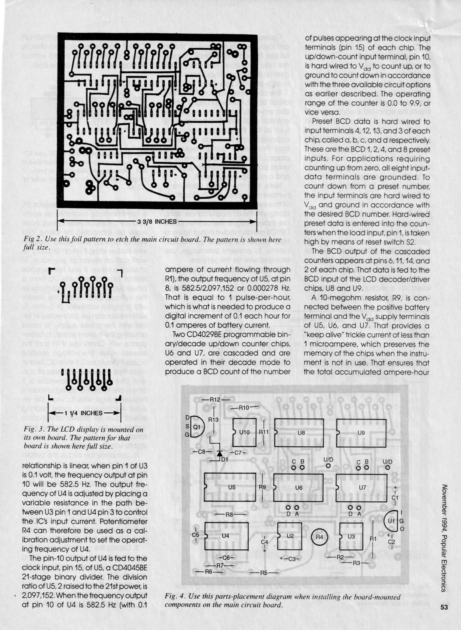

I think it is a good idea. In fact I have copy of an article written by A.J. Caristi in the November 1994 Popular Electronics magazine. It is pretty straight forward. It uses a voltage to frequency converter to convert a 0.1Ah to a pulse. It then counts the pulses on a two digit counter, which monitors the Ah use from the battery. If you would like I can scan the article and post it.

here is the article
