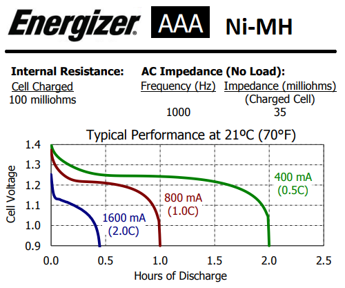

Most of my AAA Ni-Cads had a dismal capacity of only 200mAh, the Ni-MH ones are 800mAh. The Ni-Cad charge quickly faded away, it had a "memory" and it failed soon.
Here are specs for an Energizer AAA Ni-MH that has modern Eneloop technology so that it is sold pre-charged and holds a charge for one year:
You're rather missing the point - NiCd provides high current, NiMh doesn't.
Obviously NiCd batteries in power tools have been replaced by Li-Ion, which also provide high current capacity, where NiMh were never used due to their relatively low current capability.
The capacity of NiCD and NiMh are fairly similar, your experiences were obviously crap quality ones poorly used.
