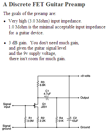

Some electric guitar players say that the preamp must have an input impedance of at least 1M ohms. This preamp has 3M ohms:
bass preamp schematic
Good piece of info there.....But can u tell me if this circuit is fully complete and accurate
just place this link in your browser.....and if there's any errors can you correct them.
