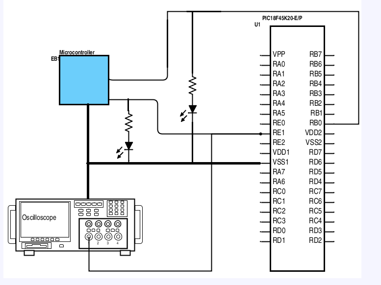

Say I have two ICs, or an IC and a component. One of the pins of part 1 is connected to one pin of part 2.
Part 1 transmit a 1 or a 0 uinidirectionally to part 2
My question is: How can I put a LED there, so that this indicates me when a 1 is being transmitted??
The parts I am using is a 3.3 V PIC for part 1 but the question is in general for a 5V PIC or any other component. Part 2 this time is a LCD, but again the question is in general

You mean something like this?
by the way, can I do something like the line with the oscilloscope to see the signal? I guess I can, just asking just in case :)
Why does your block diagram show TWO microcontrollers but no power supply?
Why does your oscilloscope have only one input wire?
Oh, I just made the draw to illustrate my point. (ergo, no power supply, oscillators, etc). I am connecting one pin from the left to the B0 pin of the PIC and transmitting 1's on left-right direction. (wanted to make sure I understood what you explained about the LED
about the oscilloscope, the input wire connects to the pin and ground wire connects to ground.
A bit more like this:
When your microcontroller is loaded by the LED's current, is its voltage high enough to be a logic 1 to the PIC?
The datasheet of the PIC will say what is its minimum input high voltage and your oscilloscope will show the actual voltage.
Then you should also measure the actual voltage at RB0.
What is the duration of the pulses?
Of course the LED must be connected to ground if its current-limiting resistor is powered from a logic "1".
