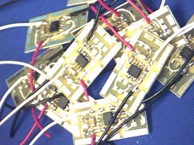

It is easier for me to make the PCB then point to point wire a board. I work out the iffy bits on a solderless breadboard and then make a PCB.
Changing SMD resistors and caps is quicker then the non-SMD ones. If there is enough solder on both ends you can wipe em off the board in a single swipe of the iron with no damage to part or PCB.
To make changes I add a bit of grass to the early PCBs. If the changes start to get ugly I make another PCB.
The schematic capture proived by Eagle helps.

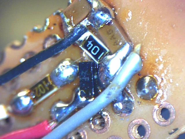

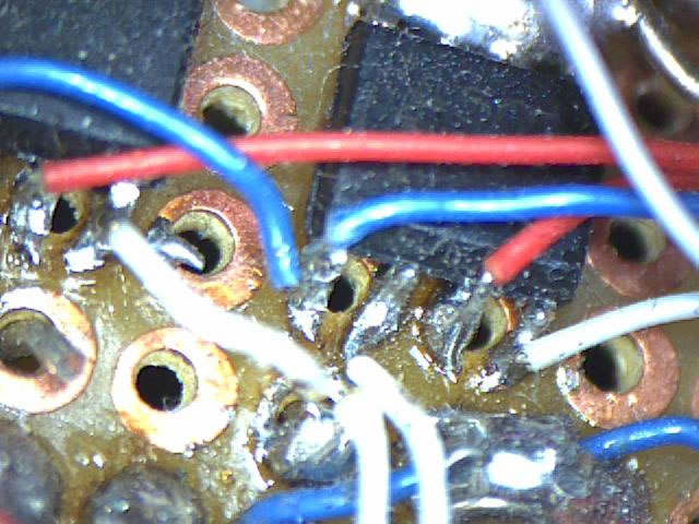

I use stripboard and the strips are already half of the wiring of a pcb and the parts plus a few jumper wires make the other half. Easy. No intermittent contacts and no millions of antennas of a breadboard.

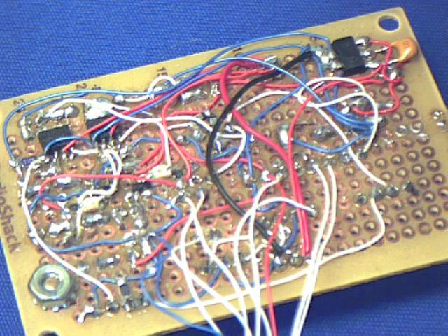

That's some crazy perfboard SMD work. Never thought I'd see that. I could have used that technique when I started and was trying to figure out what to do with the SOIC chips I had.

Strip-board is suitable for some SMT components: 805 components can easily fit in-between the tracks and SOT-23 is also easy to work with.

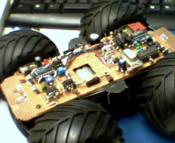

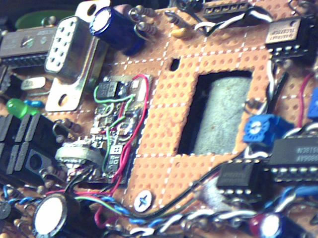

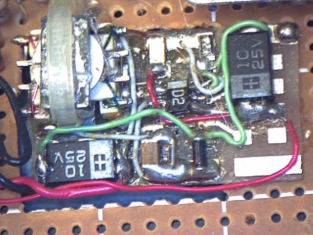

Here's another suface mount gadget I built, this is a switching regulator in a little wheeled robot -
