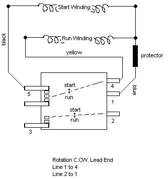

I'm brand new to electric motors and am trying to adapt a 115vac dryer motor to a screw drive application. I have the motor and after some extensive searching I found a wiring diagram that I dont quite follow. I've attached a rough reprensentaion of the scematic, can someone place the power to it and give me a brief explanation why...?
Thanks Much

Looking at your drawing, is the switch shown a centrifugal switch? If it is it would have some weights that move out as the armature spins and by doing so activate the switch over from start to run.
I have no idea why there is a second contact arrangement, usually only one is required.
The start winding is only briefly connected to start the rotor up and the centrifugal switch opens the power to it once the armature is up to speed.
The start winding is not designed for longer than just a brief application (a few seconds) of power to it. The run winding is what does the work in these kind of motors.
With your arrangement the motor would only turn in one direction only, to reverse it one would have to reverse the connection to either, the start or the run winding but NOT both. For this, the connection where the two windings join (at the 'protector') would need to be able to be broken.
To connect it to the mains just do as indicated, at #1 and # 4 terminals.
I got impatient and grabbed the fire extinguisher and tried it, took the cover off of the switch assembly so i could see what was going on in there, that switch is indeed a centifugal switch, there is lever actuated by some spinning weights inside. Do i need to ground this in any manner? Thanks for the reply.

this photo seems to have a different switch configuration than the motor i have..hmmmm...the description for this model number says its reversible..im thinking something is amiss...
Yes, it is always a good idea to ground the metal body of a motor once you have connected and bolted it to whatever use you are making of it.
Take care during testing, the motor will 'kick' on startup, tugging on the wiring in the process if you do that while the motor unrestrained in any way.
I'm sure you can figure out the yes or no reversing possibility from the info I gave you.
