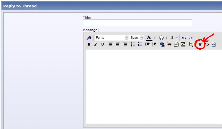

*EDIT: Please use this:
paste your program here
the text 'code' in the square bracket, followed by the program code, then '/code' in the square bracket.
I use quick reply usually :p
BTW, I can't see any menu in my reply page. There are only Title, Message, Post Icons and Additional Options. Anything missing?
So go to Advanced if you're going to post code. Pretty simple fix. :D
Or do the (code) and (/code) tags before and after your code. Replace those parentheses with square brackets. I can't actually use them or they disappear and the word ' and ' gets put in a code box.
The menu looks like this:

Don't know.. This is my advanced reply page all the while. I use typing for quote, code, bold and even smileys. colon D :D
Looks like you've got something disabled either in your profile or in your browser. All the normal menus are missing! :p
