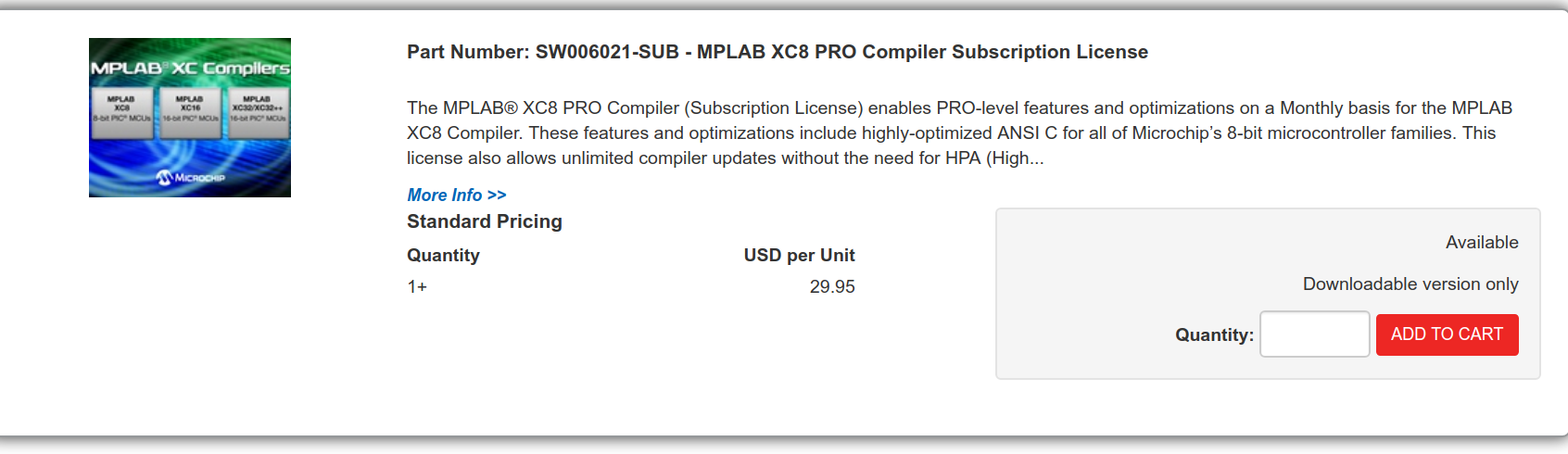

Do you have to purchase Xc8, or does it some with, or is it some silly low performance student version.
The free works good it makes a little bigger code but it's way better then any I've used.
I'm going to try the pay as go by the month on some USB stuff i want do.
You just pay when you need smaller code.
