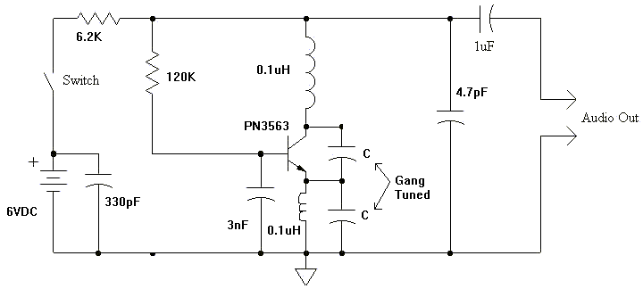

My detector is very similar to the following:
my version is shown in the attachment.
I still think the capacitor on the far right and the pull-up resistor make up the quenching frequency.

Your circuit doesn't have a quench oscillator, instead it is a regen receiver without a manual sensitivity control. The Techlib article that it comes from calls it a regen-receiver, not a super-regen. A super-regen uses its quench oscillator to make its sensitivity adjustment automatic.
A TV station requires about 6Mhz of bandwidth right?
The FM sound of a TV station has a bandwidth of only 75kHz at max modulation in mono. The AM modulated picture has a bandwidth of nearly 6MHz.
No they don't, your circuit is just an RF oscillator with a fixed bias control.

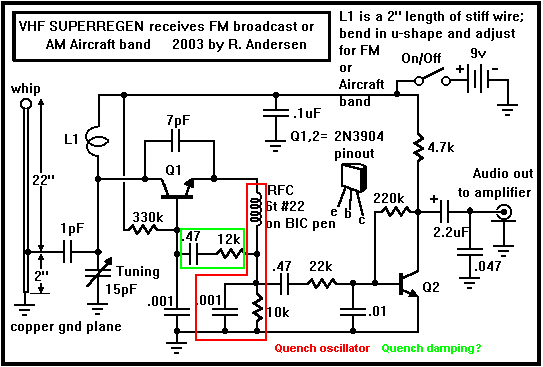

I have seen many super-regen circuits and they all have a resistor and capacitor from the emitter to ground to form a relaxation "squegging" oscillator. MStechca's circuit doesn't have any parts to make a relaxation oscillator.

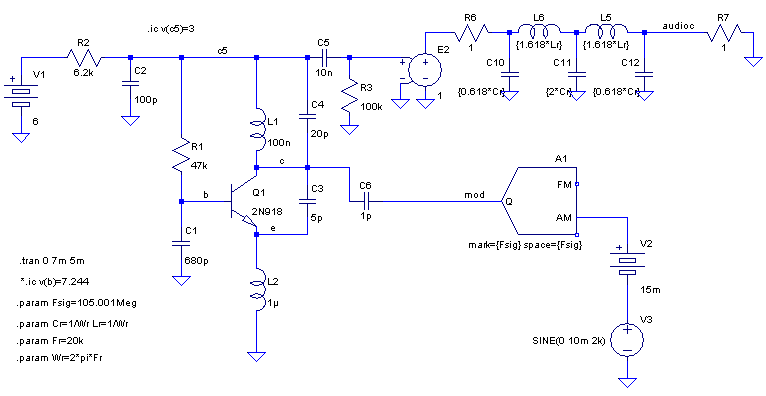

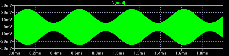

Mstechca, I don't have a clue about how to analyze or predict the self-quench frequency of this superregen receiver. That's why I sim'ed it. :) The quench (squegg) frequency is a complex situation. As the transistor starts to oscillate (RF), it draws more current. This brings down the voltage on the collector. The base current, being derived from the collector voltage,starts to decrease, but there is a lag due to the RC time constant of the base bias network. eventually, the base current is too low to sustain oscillation, so the collector voltage rises rapidly. However, there is a lag in the increase in base current due to the base bias network time constant, ... I think you get the idea.
Someone is going to say, "yeah, but one time constant in a feedback loop does not have enough phase shift to cause a single transistor to oscillate". I'm not sure how to answer that. The Q of the tank means that oscillations don't start instantaneously. The build-up of collector current is slow, due to the Q, so this is another delay.
Here is **broken link removed** I found.
Oh - I modified the schematic to something more conventional, and changed the oscillation frequency, which came out as 105.001MHz. The quench frequency is now around 150kHz.
Your original circuit oscillated at about 300MHz, and did self-quench at about 35kHz, as I said.
I used a 2N918, which was the closest model to 2N3563 that I cold find.

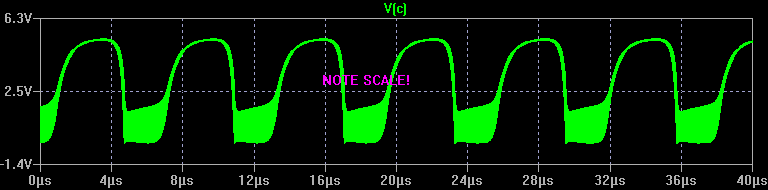

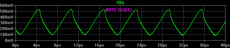

Below are some waveforms from the sim, along with the schematic. The lowpass filter is a 5 pole Butterworth. I set the corner frequency to 20kHz. The 1 ohm impedance was just for convenience. If you were going to do this in hardware, an active filter would be a better choice.
I'll have to add the other waveforms in the next post.

Here are the other waveforms.

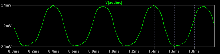

Yep. R1 and C1. Remember that C1 is also an RF bypass cap. I changed R1 from 10k to 50k, keeping the R1*C1 time constant at 33us, and the quench frequency changed from about 60kHz to 160 kHz. You don't have a scope, do you? As you can see from this experiment, it is difficult to predict the frequency.

I just explained that I don't know how to analyze it. I just chose 33us because that was the approximate R1C1 time constant in my first sim. My point was that you can't easily predict the quench frequency by knowing the time constant.
I got 60kHz and 160kHz by simulating the circuit with
1. R1=10k, C1=3.3nF (R1C1=33uS)
2. R1=50k, C1=660pF (R1C1=33uS)
The relationship isn't linear because:
1. The RF oscillation time is relatively constant for both cases.
2. The amplitude of the OFF voltage at the collector gets larger as R1 gets larger, due to the voltage divider formed by R2 and R1.

Most super-regen circuits use a bypassed emitter resistor as a peak detector so they set the squegging frequency, allowing for an adjustment of the transistor's base bias current to set its sensitivity.
