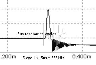

From MikeML's article, I zoomed in on the fastest ignition spark repetition rate and rise time and measured pixel width in an editor
3us (+/-20%) or 333 kHz resonance with fairly hjgh Q after detonation.

500Khz response? no brick wall filter, so AM EMI interference is likely with harmonics. carbon ignition wires essential.

I recognize the older bigger coils resonated at lower frequencies after the detonation with leaded high octane fuel burning longer.
Usually detonation is low impedance, 1 pulse , low Q ( no ringing)
and after detonation and arc extinguished, open circuit, high Q ringing.
Although I do not know the difference in detonation time for low and high octane fuel, I suspect it is in microsecond where slow burn is better for high compression with less blowby.
Of course the Cap reduces the slew rate before detonation and by resonant LC freq after. So but harmonic noise may be more problematic with DIY electronic ignition circuits.
