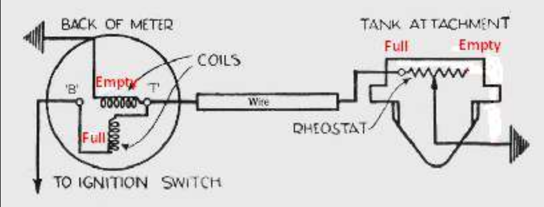

The typical automotive fuel gauge has a float in the fuel tank turning a pot that's in series with an ammeter that's the gauge. The gauge is a dual coil moving iron type which is a bit unusual compared to a typical meter used in electronics. There's a good description of the system here.
If you measure the voltage on the wire between the sender and gauge, the system is essentially a voltage divider and you can measure a DC voltage proportional to fuel level.
This works most places where it's been tried, but one place it hasn't worked is a 2016 Toyota Corolla. Instead of a swing of 4 - 6 volts across the fuel range, we are seeing readings of less than a volt from an empry tank to a full tank. I'm not quite sure what's going on to account for this small range of voltage swing.
I'm wondering if the Toyota uses a different technology for reading the fuel gauge. I have read that ethanol additives in gasoline are wrecking havoc with fuel gauge senders, and some systems are energizing the system only for brief intervals while the gauge is being read. It's the same system but instead of being powered ontinuously, it's powered only when a reading is taken. Can anyone confirm this is the case on the Toyota or how wide-spread the use of this type of system is? Any info about other systems in use?

I can't confirm that, but it seems likely. The old-school gauge was quite current-hungry. With todays's electronics it would be a simple matter to reduce energy demands dramatically by passing a low constant-current through the sender periodically and measuring the voltage with an MCU A/D input. The MCU can store the result and update an analogue or digital gauge occasionally. AFAIK the Toyota Corolla uses stepper-motors in the instrument cluster. Not sure if one would be used for the fuel gauge though.

These resistance sensors are also showing an increased failure rate with the incremental additions of alcohol in automotive gasoline fuel. Alcohol increases the corrosion rate at the potentiometer, as it is capable of carrying current like water. Potentiometer applications for alcohol fuel use a pulse-and-hold methodology, with a periodic signal being sent to determine fuel level decreasing the corrosion potential. Therefore, demand for another safer, non-contact method for fuel level is desired.

Turns out that the Toyota does in fact have a pulsed system as opposed to a continuously on system. I can't say what the on duration is, or the frequency but it turns out it's easy enough to deal with. If we take rapid measurements over a period of a few seconds and keep the periodic highest levels, we have a voltage level proportional to the fuel level. Very nice as this works for either a pulsed system or a continuously on system.

My son drives a Toyota yaris... This only reads the fuel amount periodically.. We know this because if it reads when your going downhill you gain an extra bar on the gauge, and will be some time before it restores the gauge....
Most fuel gauge systems have a regulator.. It used to be 7 volt via a bi-metal vibrator but I'm sure they are in the 21th century now..

What I remember for the Chrysler. was it was on the order of seconds. I think the problem turned out to be the dash movement. I think it was a constant voltage pulse through the sender and the meter read the current. I know I put a lamp in place of the movement until we got a replacement.
