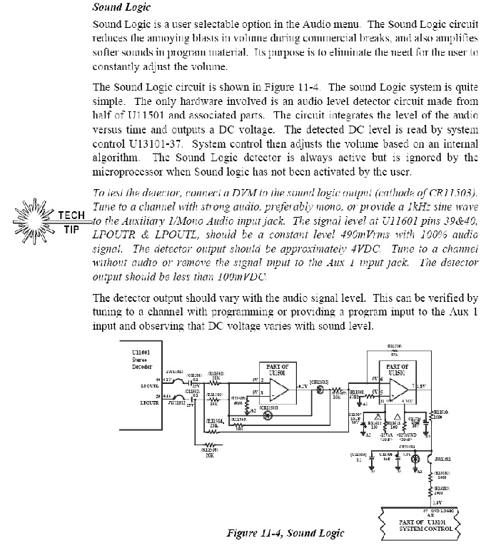

This is what RCA has to say about their Sound Logic circuit in a Technical Training manual I found. One wonders what the algorithm is they mention. [Sorry about the quality of the file.]

Thanks CCurtis!

Rather a rip-off price - the 'electro optical attenuator' is just a small incandescent bulb heatshrunk to an LDR.
It's a common cheap and easy way of doing it, and the incandescent bulb automatically performs a fairly reasonable attack and decay.
