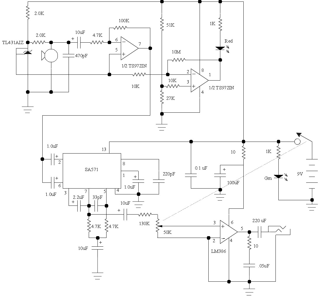

My hearing for frequencies above about 1500Hz is very close to 60db below normal so watching TV with the wife was a problem for her in that the volume had to be quite loud for her and I could not hear some audio or it was not clear.
I built the attached circuit. The SA571 is a compressor that keeps the audio level pretty constant. One section of the TS972 op amp is a voltage detector that turned on an LED to let me know the voltage of the 9V battery was low.
As I recall the SA571 is dual channel and I am only using one channel. Since I use headphones, they are wired in parallel.

I had a Toshiba TV that had ALC.
When the program sound was at a low volume then the TV slowly boosted it until the backgriund sounds were much too loud. Then when a loud sound came its first few hundred milli-seconds were blasting loud until the circuit could reduce the volume. Each loud sound was like a huge hammer hitting my head. It was absolutely useless.
