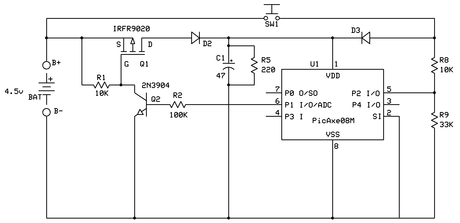

So here's mine.
Pushing SW1 powers Vdd through D3. The programs pulls P1 high, turning on Q2/Q1, which latched on the power to Vdd. The program then sets an interrupt for P2, and goes on it's merry way. When SW1 is pushed again P2 is pulled high and the program jumps to a shutdown routine that pulls P1 low, turning off Q2/Q1 and goes to END. The program can also shut the power down as part of another routine. R8/R9 provides pullup/pulldown for P2. D3 isolated R8/R9/P2 from Vdd. C1/R5 provides a slight delay in the loss of Vdd, so the program can END gracefully.
Ken

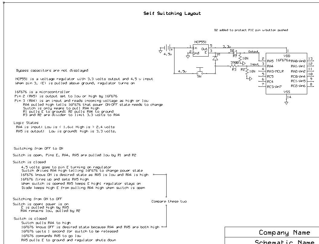

Here is a switch I use. It employs a voltage regulator with enable pin.
