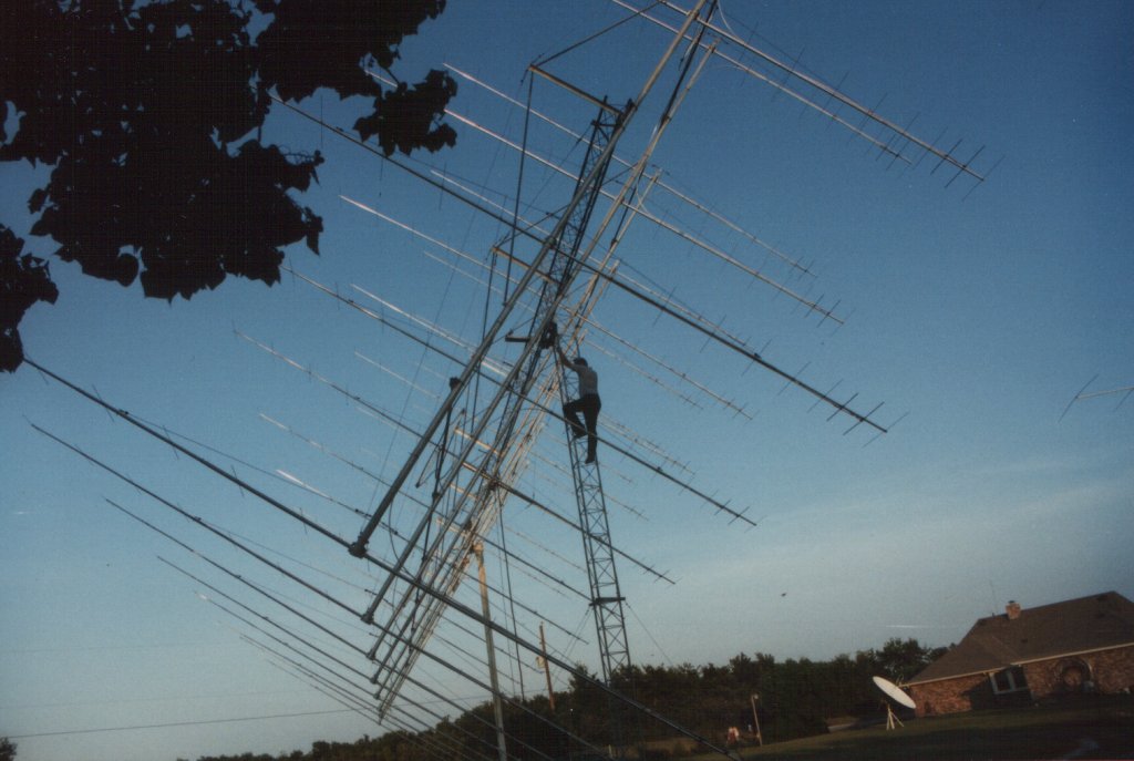

Here's a picture of one of the most powerful amateur "moonbounce" antennas built so far -
It consists of log-periodic dipole elements, is directional, handles high power, is well known for being able to bounce signals off the moon, and something a motivated science chick could build.

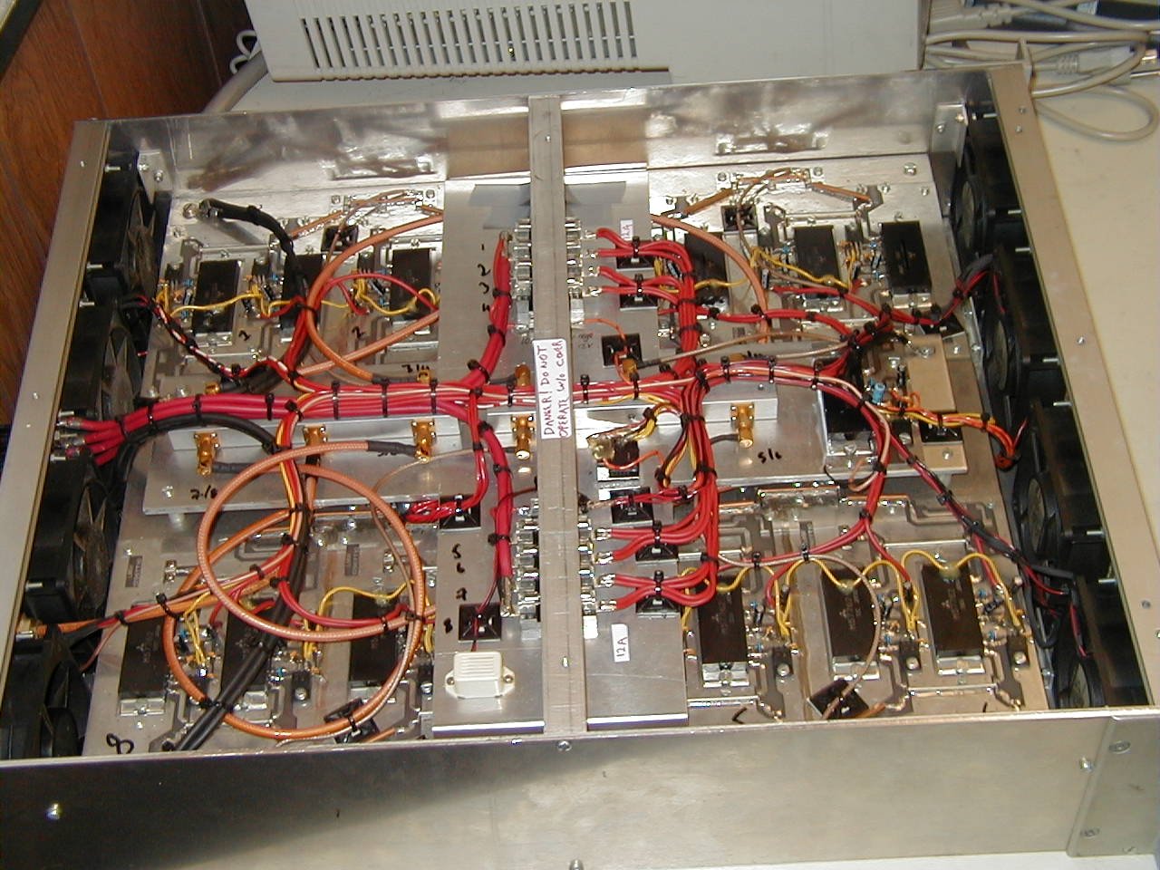

Here's a couple of pages with great pix of high-power finals, to give an idea what might be involved -
http://www.nd2x.net/N2UO.html
http://www.cqdx.ru/ham/new-equipment/qro-tsunami-rf-linear-amplifier/
Those are in the 2 - 10 meter range.

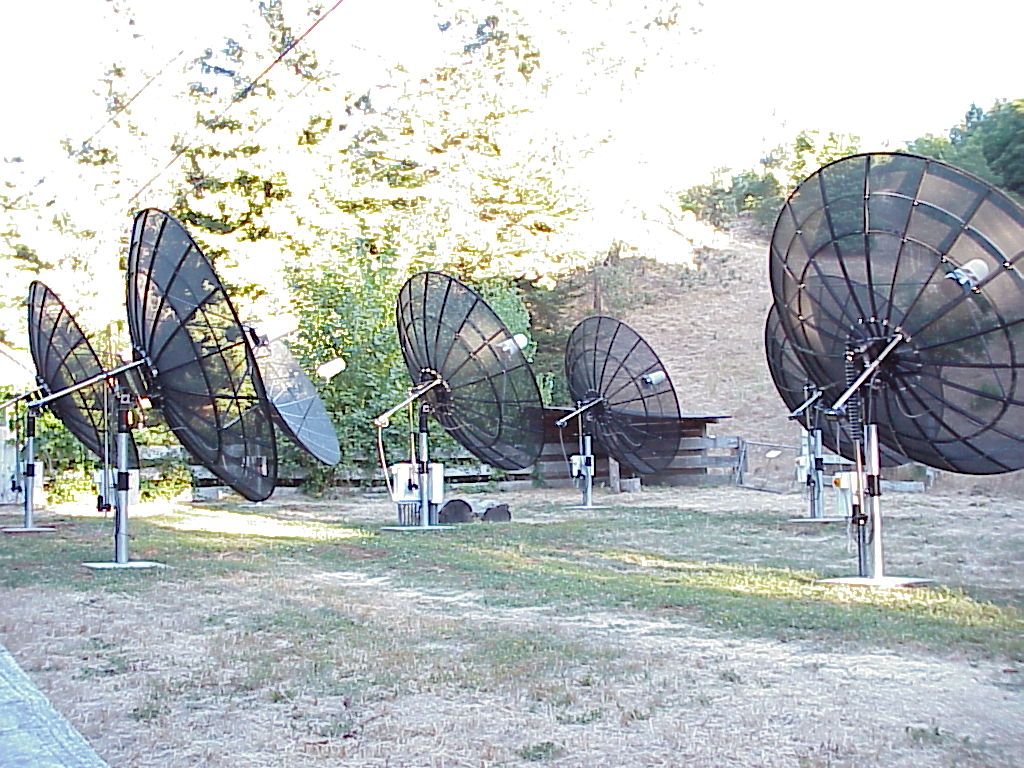

Or she might go with a higher frequency and use an array of surplus satellite dish antennas...
...build her own solid-state final amplifier...
...use a microwave signal generator for the exciter, and frequency stabilize it with an atomic clock - both of which can be acquired from eBay relatively cheap.
