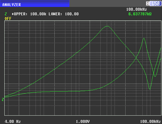

To see all this in action, I've taken a small output transformer with a 5k ohm rated primary impedance and an 8 ohms rated secondary impedance and measured the primary impedance with an open circuit on the secondary, and with a short on the secondary. The primary impedance magnitude was measured with an impedance analyzer from a low frequency of 4 Hz to a high frequency of 100 kHz. The impedance magnitudes are plotted on a log-log graph with 4 Hz at the left edge and 100 kHz at the right edge; major vertical lines are at 10 Hz, 100 Hz, 1 khz and 10 kHz. The impedance scale goes from 100 ohms at the bottom edge of the plot to 100k ohms at the top, with major horizontal lines at 1k and 10k ohms. This plot is shown in the attachment.
The top green curve is the primary impedance with the secondary open circuited (Zoc), and the bottom green curve is the primary impedance with the secondary shorted (Zsc).
The primary impedance can't be any greater than the top curve, no matter what impedance is connected to the secondary, and also can't be any less than the bottom curve no matter what impedance is connected to the secondary. In other words, the impedance we measure at the primary must always fall between the two green curves (up to 20 kHz or so), whatever resistive load we connect to the secondary (capacitive loads can cause the impedance to go a little above the upper green curve, but I'm not getting into that now).
We see that starting at the left side, the upper curve rises as frequency increases. This is because with the secondary open circuited, we are getting no transformer action, and we are just measuring the finite inductance of the primary, whose impedance increases with increasing frequency, as inductors do. Eventually we reach the self-resonance frequency of the primary at about 3 kHz, and then the open circuit impedance begins to decrease with increasing frequency, because the impedance is now capacitive. This is one of the limitations of a real transformer versus an ideal one.
The maximum impedance occurs at the first parallel resonance of the primary winding, but we see that there are more resonances at higher frequencies; for example, the first series resonance, giving an impedance minimum occurs at about 48 kHz.
The lower curve which is the primary impedance with the secondary shorted starts out at about 300 ohms at 4 Hz, and is nearly flat until about 1 kHz where it starts to rise due to the leakage inductance. We see a couple of resonances at higher frequencies. Since the secondary load impedance can't be less than zero ohms (we won't consider negative resistances), the primary impedance must always fall above the lower green curve up to about 20 kHz.
Unlike the ideal transformer which can be used with any value of secondary impedance, this real transformer can't have a primary impedance of greater than about 21k ohms at 1 kHz. This means that if we connected a secondary impedance of 64 ohms, the ideal transformer would transform that to a primary impedance of 40k ohms, but the real transformer just couldn't do that. The real transformer's primary impedance can't be more than about 21k ohms at 1 kHz; the real transformer's ability to transform impedances is limited by its losses.
This defect doesn't just kick in at a primary impedance of about 20k ohms; as soon as you move away from the optimum primary impedance of 5k ohms, the effect begins to occur. I'll discuss more in the next post.

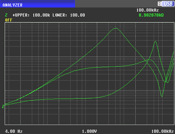

I've attached another image to this post. It shows the same open and short circuit impedances as the image attached to post #1, and in addition it shows the primary impedance with an 8 ohm resistor connected to the secondary as a third curve between the open and short circuit curves.
The expected primary impedance with an 8 ohm load on the secondary is 5000 ohms. The measured impedance (middle curve) approaches 5000 ohms after the frequency goes past 1 kHz. This middle curve is more or less halfway between the upper and lower curves, which would be the image impedance, once the frequency is above about 1 kHz. At 100 Hz, for example, the measured primary impedance with an 8 ohm load is only about 2500 ohms; this result is due to the small size of the transformer, only about 10 watts.
