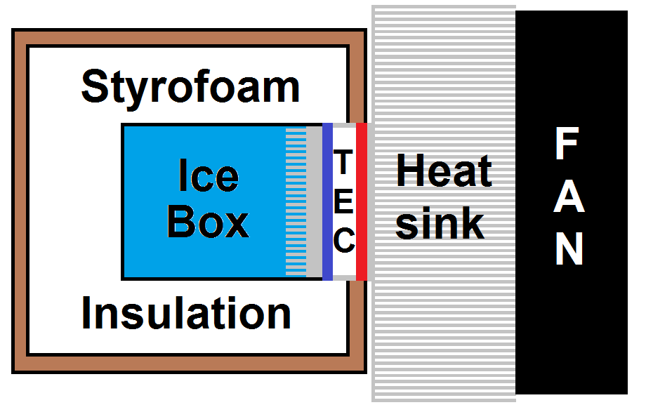

You need to make a box, out of insulation, with one side the cold of your TEC, and the other the heat sink.
Like this....

Heat pump = peltier = TEC. All the same thing.
how can i lower it the peltier temperature, use 2 peltier 150W cold side to heat pump, cold side to hot side?
Yes. Cold side of one, hot side of the other.

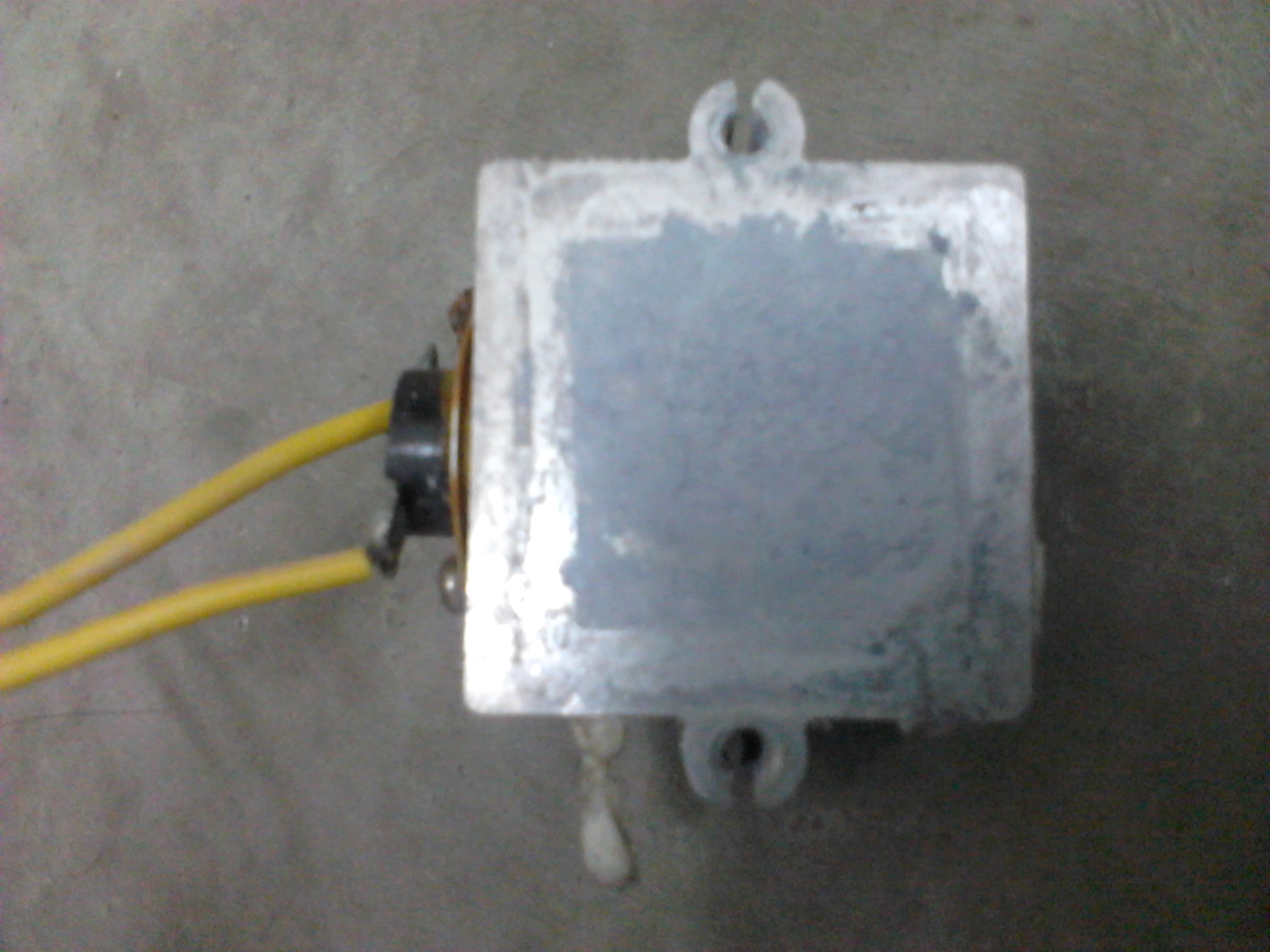

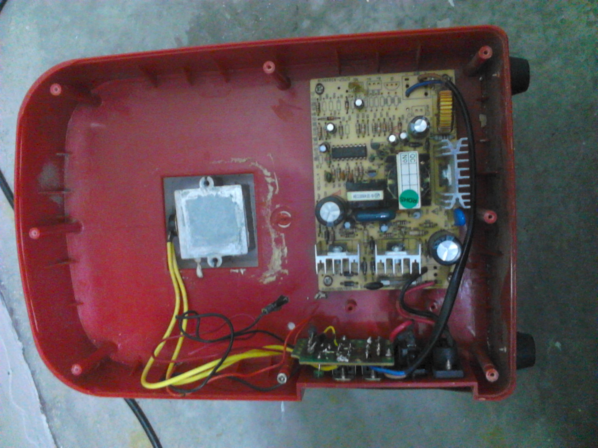

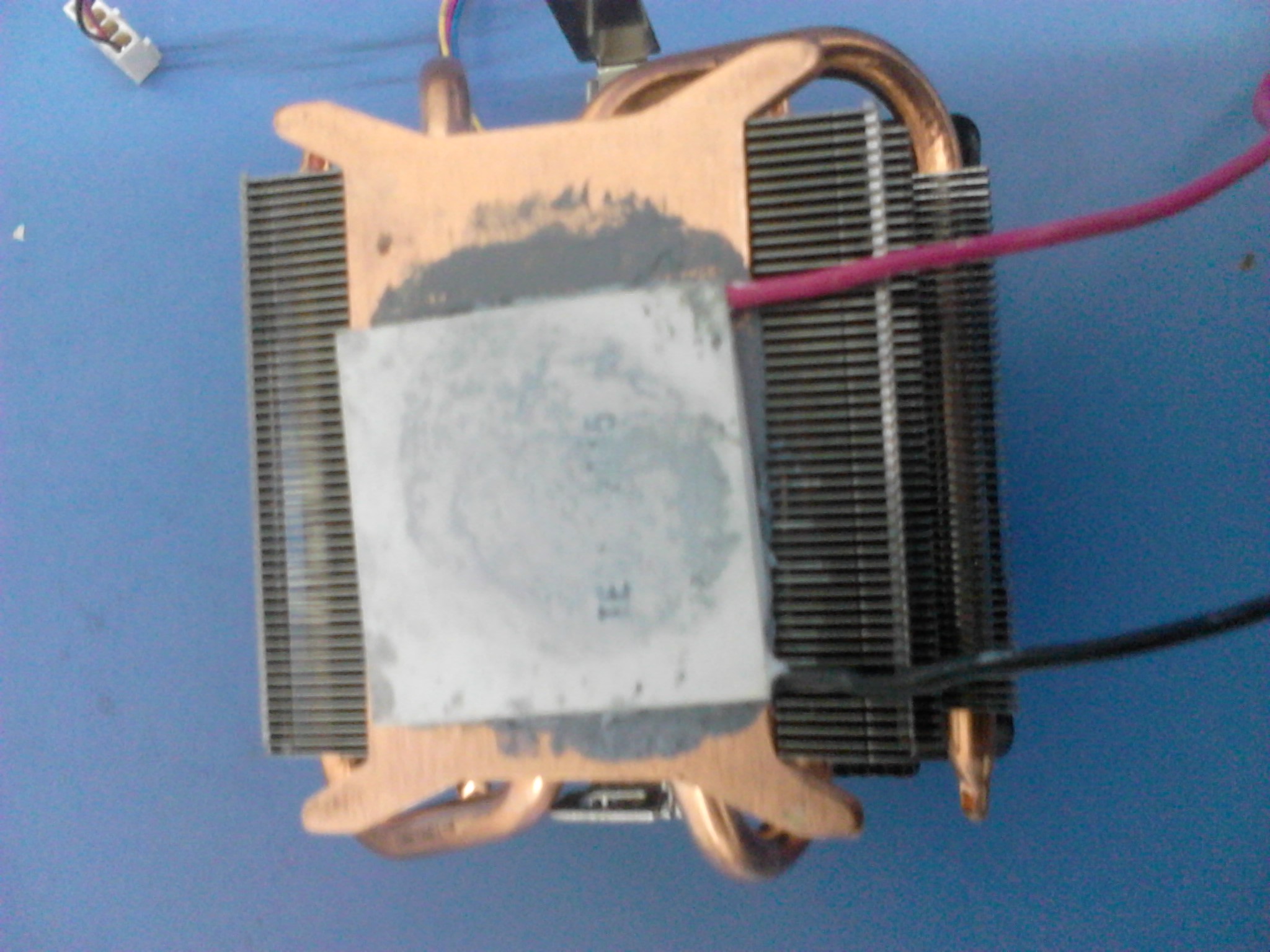

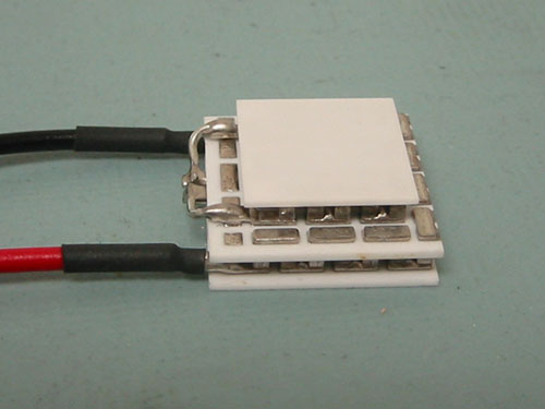

okay here the story... i got mini cool box from my dad to use in college, then after few month the Peltier not function anymore so i can fix it by change the peltier but i think if i going to change the peltier better i use bigger Power(W) peltier to make it more cool(low temperature) or even can make ice... u post a picture of multistage peltier, i think i will not found that one in my country, so i will attach two peltier each other but can i use high Watt peltier to box then lower watt peltier to cool the peltier hot side or it need same Watt peltier? what effect the peltier cooling or function, current or voltage so i might know it need to set as parallel or series...
i upload picture for my setup... pls guide me...

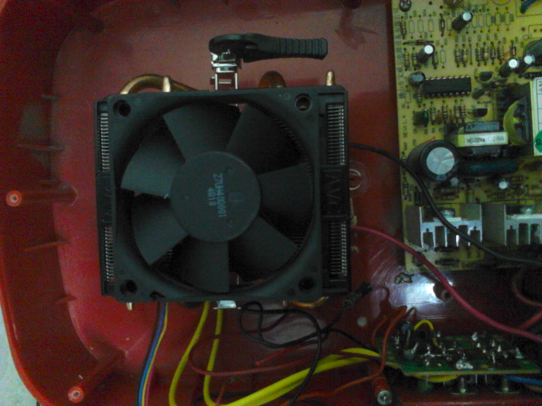

here the box :
inside the box
back of the box (i not use the powersupply circuit anymore and use other powersupply because it generate heat and reduce the cooling in the box)
The thing is already old and found an open area when closing the box

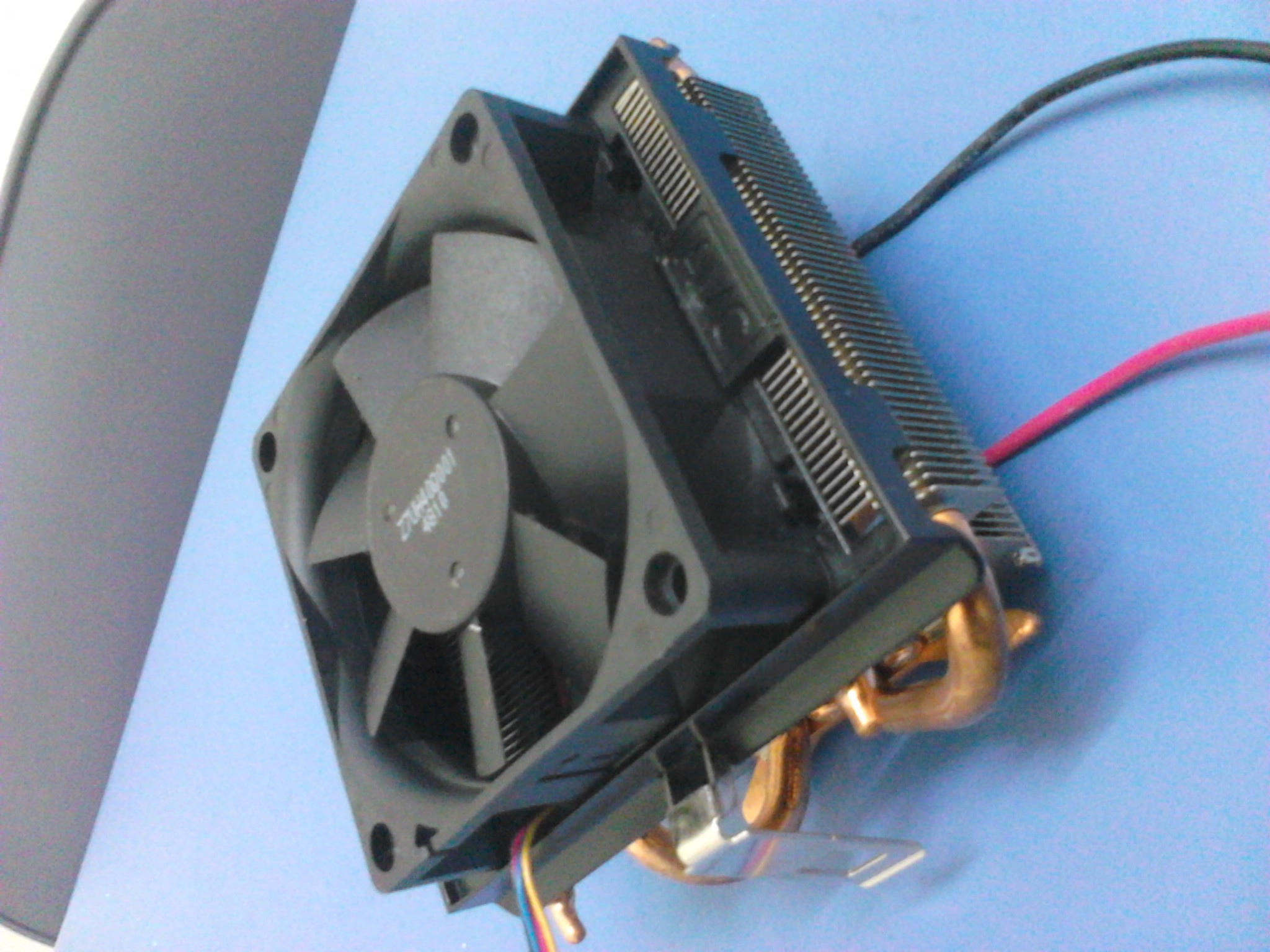

My AMD stock air fan
Peltier

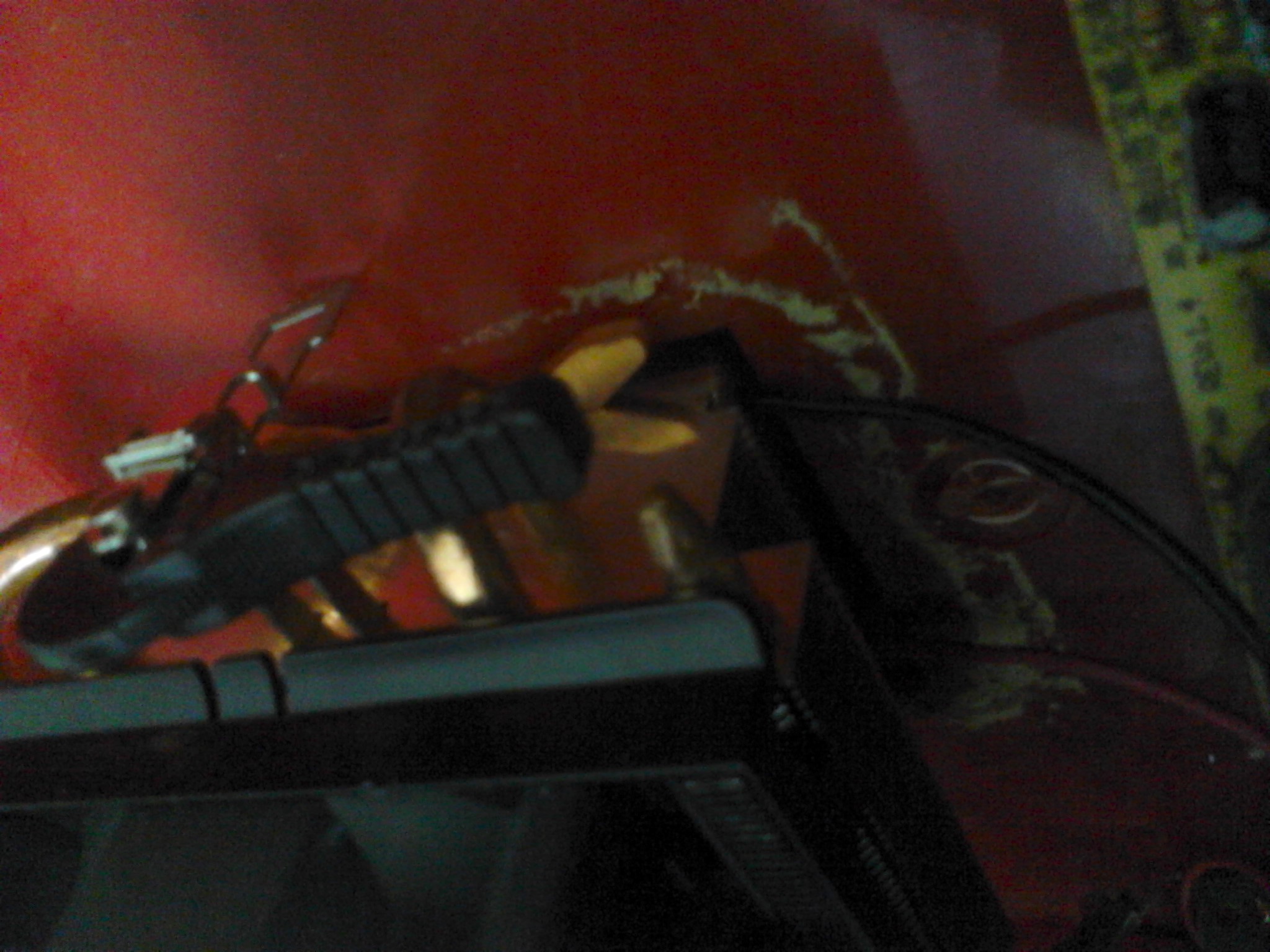

position/location of peltier and air fan
got open hole/leak when peltier in it position but never produce water at the back of the box only in the box got water produced
To make a two stage Pelter cooling system work you will need to have the higher wattage one cooling the lower wattage one. Overall cooling efficiency will be lower but the cold side temperature limit will be lower in exchange.
Depending on the cooling efficiency of the higher wattage unit you may need a 2:1 or possibly a 3:1 wattage ratio between them which means that your present 150 watt cooler would be the large one and the smaller second one would need to be in the 50 - 75 watt rage if they are both of reasonable efficiency. If not you smaller one may have to be down in the 40 - 50 watt range.
Also the larger cooler will need to have a good sized heat sink being that it will be trying to dump as much as 300 watts of heat energy at any one time when the system is running.
As far as making ice it should be easy if your box is insulated well enough and you can keep your outside heat sink temperature as close to ambient temperature as possible.
One issue I see is that using a common computer power supply is that its wattage rating is intended to be spread out over all of its outputs and not just one output such as the 12 VDC circuit. Trying to pull all or nearly all of the rated wattage off of the 12 VDC output alone will cause it to have a short life expectancy and typically very poor voltage regulation when it is working.
Ideally you should have dedicated power supply if you are planning to be running higher wattages on a single output system.

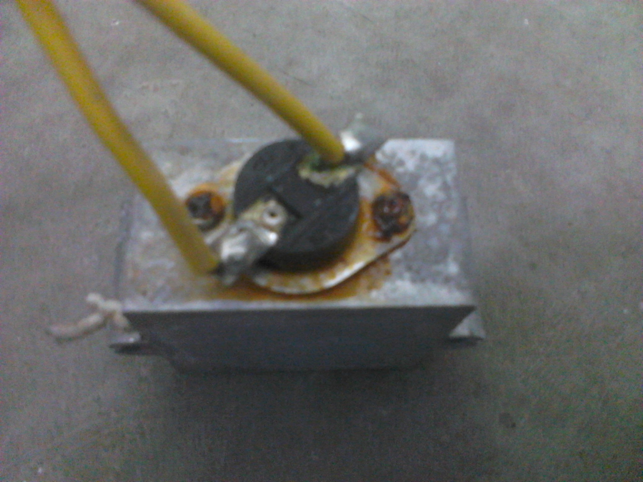

where is the transfer side of the peltier located on the inside of the box?
inside the box got square line and 4 screw...

for heatsink and fan here is more specification:
Material: Copper heatpipes, base w/ bonded aluminum fins
Heat Sink Size: 92W x 95L x 64H
Fan Size: 70 x 70 x 20mm
Voltage: 12VDC
Bearing: Dual Ball Bearings
which one should i change? if both, how to choose?

It looks like a thermal switch, It opens when it get to a certain temperature and closes when it cools down.
