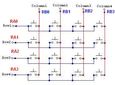

Actually it's not a school project. Few months ago I built a circuit which is operated with 4x4 Keypad to open a lock. I used a 4 digit password. It used a shift register and logic gates. But there was no way to change the code except the changing the wires. So I decided to modify the whole concept, using a microcontroller so that there would be a code changing option and also has some kind of display. The MCU would operate a relay when the code matches. I have found a ready made project which has every thing including hex file for two different PIC but I want to make my own. That's why I'm interested in learning MCU.
Well, I have decided to stick with PIC. I'm learning F84 programming with assembly(50% of the tutorial is complete). I also know that I need a PIC16F628 for my project. So I hope I can also program it if I can learn F84.
I want to know few things:
How do I store a data in the PIC say a 4 digit password which I can change with a keypad later?Which one is the EEPROM??(e.g. for 16F84)
How does a keypad is recognized?say Col1 and Row1 (Row1 to RA0 and Col1 to RB0 pin)is the button for '1'. How does a PIC identify it and compare it with some stored value?? Is this done by logical operations?
For the keypad: Do I need to connect the row or column to any operating voltage via resistors? Or just connect the ROW and Column connections to the MCU PIN?

ya datasheet...
Nigel Goodwin said:
Yes to both - but the 84 is an absolute antique, it was replaced by the 628 last century, but appears to have been re-introduced for all the idiots who keep buying them, and paying extra money for them!.
As written in the datasheet...
Regards,
Simran..

Like I said previously, read my tutorial, there's one that does almost everything you want (in the HEX keypad tutorials). The last IR tutorial also shows how to read and write the data EEPROM.
