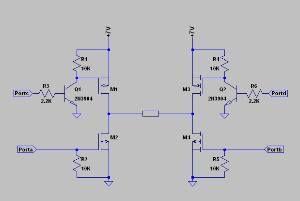

I'm a beginner at electronics, any any feedback would be helpful. So, the basic rundown: I have two motors, and I would like to run them both backwards and forwards, so I need an h-bridge circuit. However, I'm not sure if I am wiring them correctly.
Here are the h-bridges:
The D pins refer to pins on an Arduino UNO, which are capable of digital writing.
Here's my thinking:
On Motor 1, if I want to move it forward, I will turn on Digital Pin 1, and turn off Digital Pin 3. If I want to move it backwards, I will turn Digital Pin 1 off, and Digital Pin 3 off.
Also, will I need capacitors / flyback diodes for the motors?
Thank you for any help!
Your biggest problem is the upper MOSFETs as these will require a gate voltage that is 8V higher than their source voltages. With a 7.5V supply (upper source voltage) they will need around 15V on their gates to turn on. Normally the high side MOSFETs are P-type that need a low voltage on the gate. Your other problem is charging the gate fast enough from an Arduino. Depending on what current your motors require I would choose a suitable chip.
Edit, you will need a snubber circuit for the motors. Google DMOS H-bridge and study some of the datasheets.
And it is best to use four port pins on the Arduino to guarantee that you always turn off the upper PFET first, followed by waiting for the motor to coast to a stop, followed by turning off the NFET, followed by turning on the opposite NFET, followed finally by turning on the opposite PFET, with delays of 10 of us to 100 of ms as appropriate.
Everybody that tries to do this with just two port pins ends up blowing FETs before they get it right.

Okay, so I have changed all the upper N-MOSFETs to P-MOSFETs, and each MOSFET is connected to its own individual pin. If I understand correctly, I will need to use delays when programming in Arduino so I can control all the gates properly. Here's the updated schematic:
Is there anything else that I need to change, or have missed?
Your P-FETS wont turn off properly and your N-FETs won't turn on properly which will lead to both emitting smoke. Learn about how MOSFETS work or use a chip as suggested above. Sorry to be so blunt.
Logic-level NFets can be controlled directly from 5V powered Arduino pins; PFets where their Sources are connected to a voltage higher than 5V cant. You need some sort of level-shifter logic between the port pin and the PFET gates. Either DIY or a chip made for the purpose...

Good as far as you went. There are 2^4=16 total states.

Have a look at the L6203 chip as this will do what you need. If you have to design one using mosfets then it's a lot more tricky than your lecturer has indicated.
I was planning to buy this chip: https://www.sparkfun.com/products/9479
I'm probably going to end up not making my own H-Bridge circuit, as it's a huge headache.
I dont like that chip much. The voltage drops across the PNP and NPNs are such that if you start with a 7V motor supply, you will only get ~4.5V across the motor.
Here is useable (but not great) H-bridge that will work with the 5V Arduino. I would hook Porta and Portb to PWM-able pins. Since the Arduino PWM rate is only 500Hz, the losses (heating of the FETs) wont be too bad. Q1 and Q2 provide the requisite level shifting. When writing the code, watch out for all the non-allowed states... With a 7V motor supply, M1 through M4 should be suitable logic-level-gate FETs.
