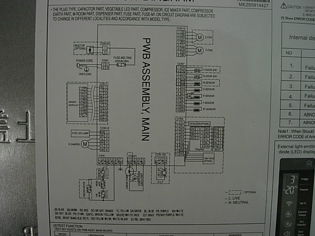

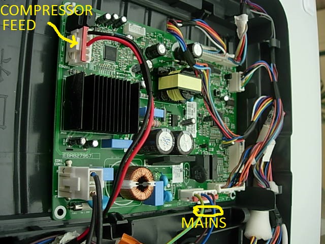

This is a LG variable speed linear compressor inverter driven. The compressor is basicly a Solenoid driven piston. The powersupply is a switch mode power supply. The fridge will run comfortably of a 300Watt 12V-250Vac inverter as it only draws 15W to 50W during cycles & 150W on defrost cycle. I would be hesitant to run it of a modified square wave powersupply. These fridges dont use mutch power. Other inverter fridges use a variable speed rotary type compressor.

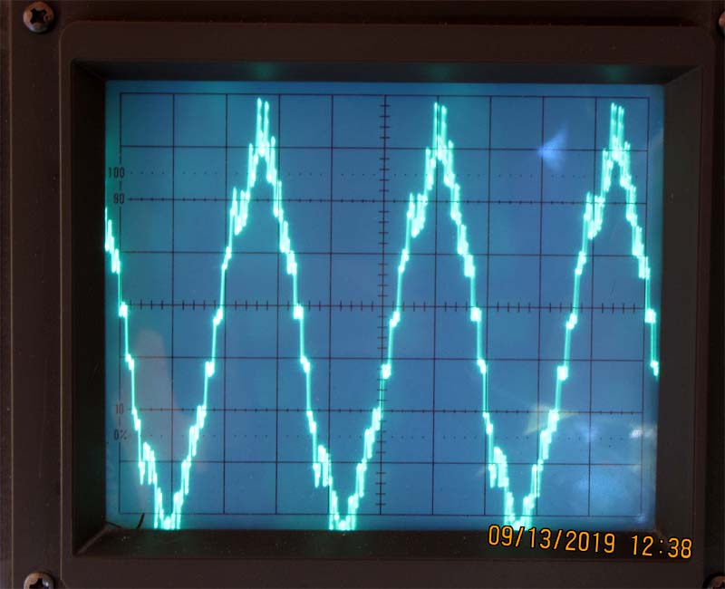

I have posted the waveform from the generator in question in elsewhere....here it is.....
Coleman PowerMate 5000watt open frame generator (6250watt peak). Purchased in 2005.
powermatenon-inverterwaveform-jpg.120542
Maybe someone with a better understanding of harmonics can tell us if this is a potentially harmful Sinusoidal wave form.
It has "some" noise apparently, but overall not a terribly bad waveform. I didn't see any major spiking of voltage.
How did you connect the oscilloscope to measure that waveform?
