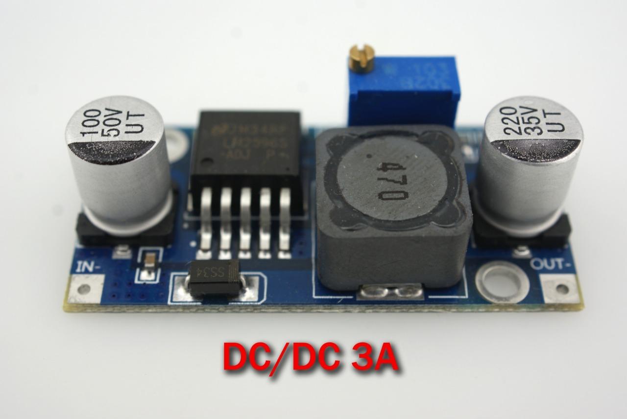

Here is an example of a DC to DC supply that will buck down a voltage as high as 35V and make a voltage like 8V for yor Arduino.
Smaller version 28Vim max!
I don't see it today but there is probably a 1A version on ebay.

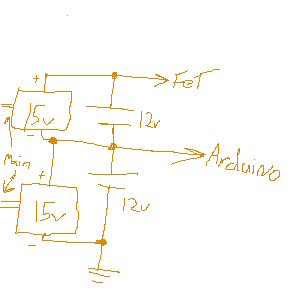

here is my idea.....

....that it is safe to stack my 2 chargers in series just like i am going to stack my series batteries, also is it good idea to put that center node in there between the 2 batteries &chargers , i figure this will make for more balanced charging, rite??
also is it essential to disconnect charger if batteries are fully charged? or can i leave it all hooked up and continuously feed..like my alarm system?
Why not leave the batteries in series, and use a regulator like the one ron pictured to regulate the 24v down to a voltage suitable for the 'duino.
The you can leave the charger connected to the batteries all the time, when mains is on the charger will keep up with extra power for the 'duino the regulator circuit taking care of the extra voltage, then when the mains goes the regulator circuit will run off the batteries, some of the better ones also have an undervoltage shut off you can use to protect the batteries.

well, arduino has internal buck to 5v, but not enough current for all the 12v fets, so i have additional buck(like rons) for 5v@3a, plus i found some of the load devices(water pumps) work better at the 15v, was hoping to keep it there, plus another load device at the 24v end.... aiming for less circuitry.... I think existing plan will work fine,... now that i realize that arduino can go to 15v
.... i think i am just hooked on the idea that 2 parallel chargers is better since they would individually charge their own batteries, (and not need to send current through battery 1, just to charge battery 2 ... since there will be high(er) power draws but for smaller periods of time in the 24v circuit, at the 12v side there will be constant low power draws with additional low period(1minute every 4)-high power (12v) draws plus the 24v draws. ... so the 12v side battery will be used more, there is no reason to pass additional current through first battery... ..... this maybe a concept i should drop...

Hy Dr_Doggy,
Your serial connected lead acid batteries with separate isolated chargers for each battery would be ideal as each battery is charged according to its needs. But, as in automobiles, the chargers must have a current capability at least equal to the maximum current drain from each battery
You have 15V supplies to charge each battery and, as Mike says, you need 13.75V, with a negative temperature coefficient, for constant charging. Well, you can make a pretty good attempt at this by simply putting two 20 amps or so silicon rectifier diodes (not schottky) in series with each 15V supply. The temperature coefficient will be the wrong way (2mV per degree Centigrade) but, while not ideal, it should be OK- lead acid batteries are pretty tolerant. Just look at how they are treated in automobiles.:)
It would be best if the diodes were mounted on a decent heatsink. TO220 case diodes would be ideal.

Yes I think I got that, and I agree if the load on the 2 12v batts isnt equal then separate chargers might be better.
One thing you must make sure though is that both the supplies are isolated from each other, server and pc supplies often have the - output grounded, so if you connected 2 of them to 2 batts then you'd short one of them out, the o/p's must be floating with respect to mains.
Yes why not use the 'duino to control the state of charge, so long as the ground of the 'duino is one end of the batteries (ie not the tap between them) you can measure the voltage of both, you would need some way to control the charge current transistors though, maybe an opto isolator, or I might be inclined to use a fet and drive its gate from the arduino via a gate drive transformer and maybe a gate driver ic.
Power for this can come from your supply bricks, if the 'duino is powered from one you only need to isolate the other.
