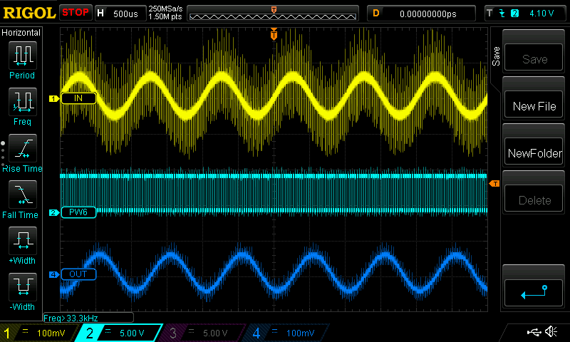

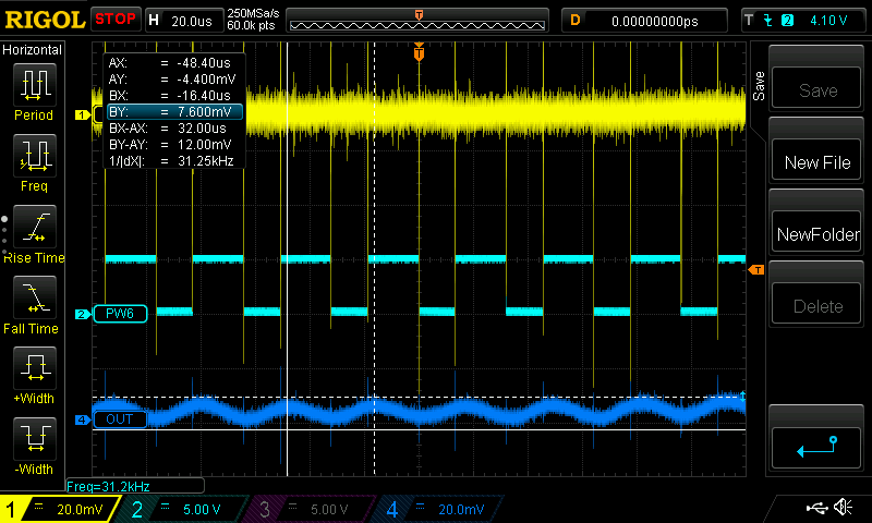

Here is the latest scope capture of the input and output signals. The trace is being triggered by the PWM transition.
As you can see from the scope capture of a 1 KHz sine wave, the input spikes from the PWM are greatly attenuated but they still produce too much noise.
The output waveform has a slight 31KHz ripple but it's insignificant compared to the ~30mV spikes.

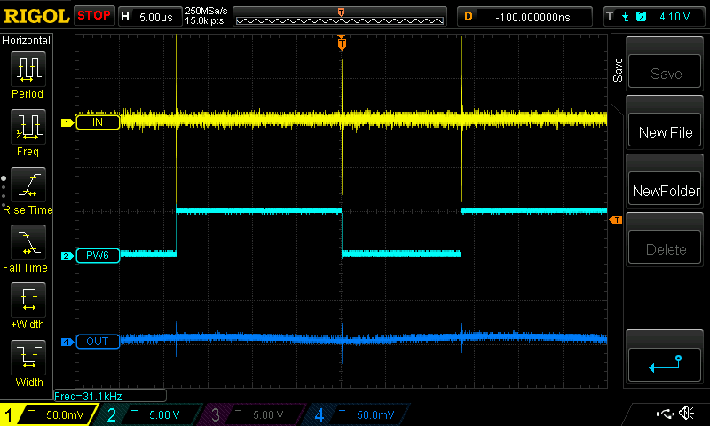

Here is a close-up of the effect the PWM spike has on the input and output signals. In this case the input signal is NULL.

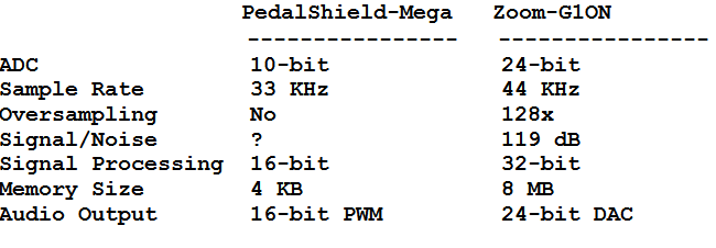

Here is a table of a hardware spec comparison:
Just by highlighting the main specs it's pretty obvious just how pathetic the Arduino Mega + Audio OpAmp shield is compared to a commercial product like the Zoom G1ON.
The main processor used by the Zoom is a TI TMS320 DSP and is likely 1000's of times faster than the Arduino's CPU.

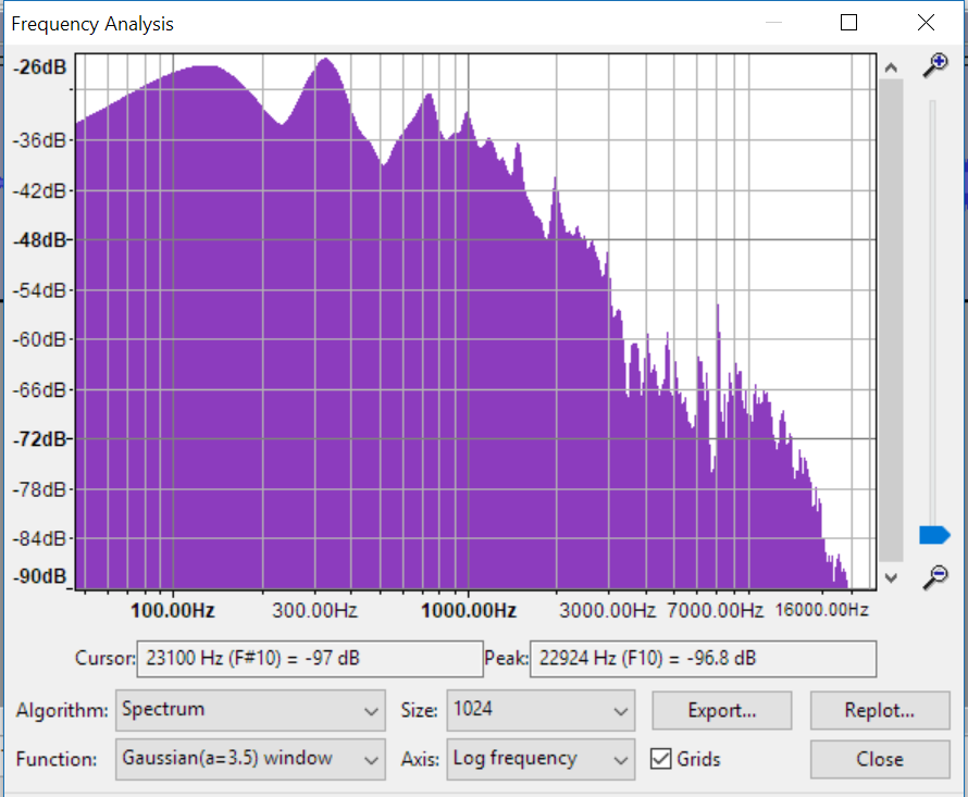

Seems to be mainly low frequency noise. This is what Audacity thinks the spectrum looks like :-
What you're seeing in the graph is the effect of the RC filter on the output signal, I've designed the output filter to attenuate signals above 4KHz.

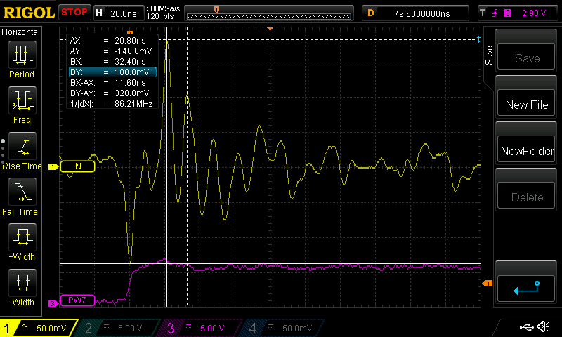

The dominate source of noise can be characterized as a high voltage spike at high frequency. Here is a capture of the 5V Vcc input. In the scope capture in this case, the yellow IN trace is 5V (AC coupled) not the input signal (as was the case in previous captures). This spike gets superimposed onto all of the circuit signals by differing amounts. Notice that the spike is at very high frequency (86.2 MHz) and is a result of the voltage regulator responding to the voltage drop caused by the PWM signal going high. The voltage regulator takes a bit of time ~200 nS to stabilize after the PWM state change.
At audio frequencies this spike just looks like a sudden jump (the frequency component can pretty much be ignored) and causes an audible "pop".
