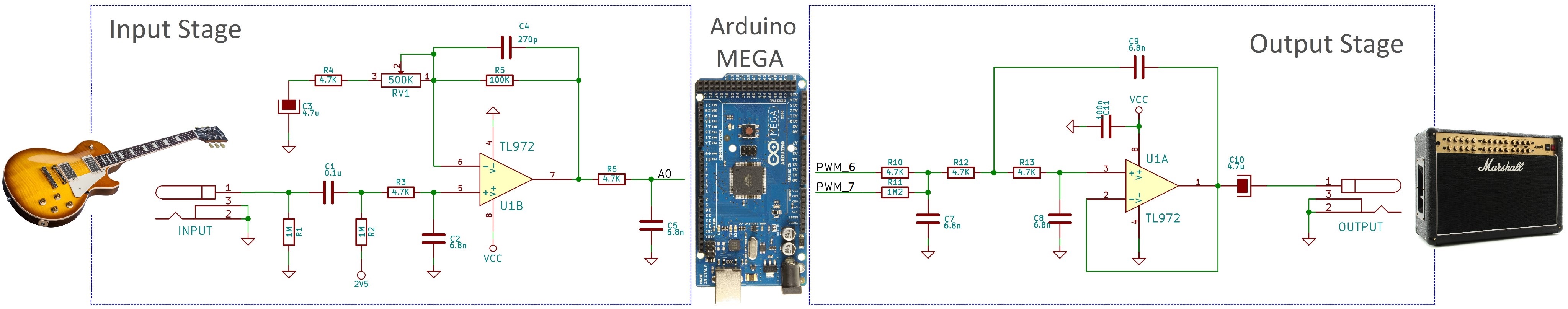

I followed the ElectroSmash schematic for the input and output stages:
I've got the input and output stages built and the effects processor "works". Here what my PCB currently looks like:

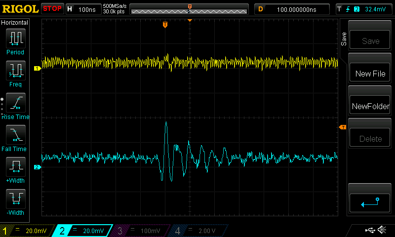

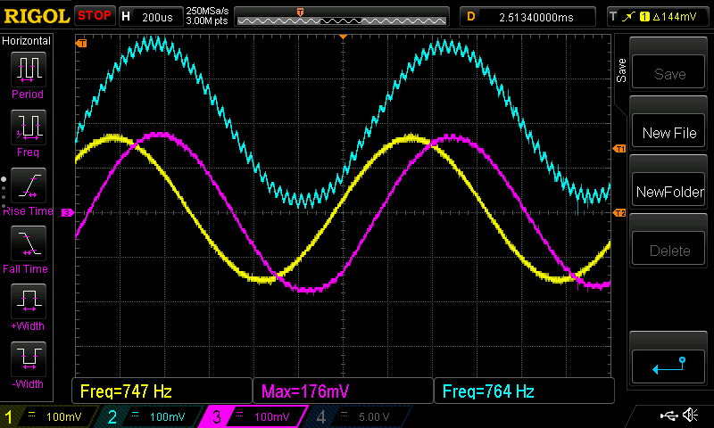

The input signal is the Yellow trace. The Blue trace is the output signal of the original circuit. Notice that not only does the Blue trace have significant triangle wave noise at 31KHz but it is also DC offset by about 200mV. The Pink trace is the output signal after running the output through a low pass RC filter (to get rid of the 31KHz noise) and a 0.1uF capacitor in series (to get rid of the DC offset).
With the output signal looking much better after the additional filters I still wasn't too happy with the sound of this thing although it did sound much better than before the additional filters were added.

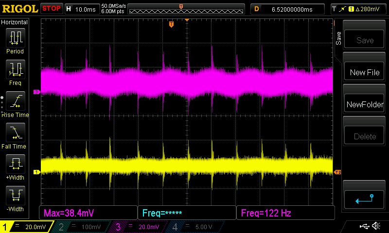

Looking at the signals with no input waveform and zoomed in on the vertical scale I saw something that was causing some of the noise:
Again in this trace Yellow is the input signal and Pink is the filtered output signal. The frequency of the noise spikes in this case were about 900Hz.
After much head scratching I decided to disable the software loop that was flashing an LED during the effect processing and this turned out to be the cause of these spikes pictured above. The current draw from the LED switching on and off was effecting the voltage levels of the Input stage of the OpAmp apparently.

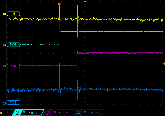

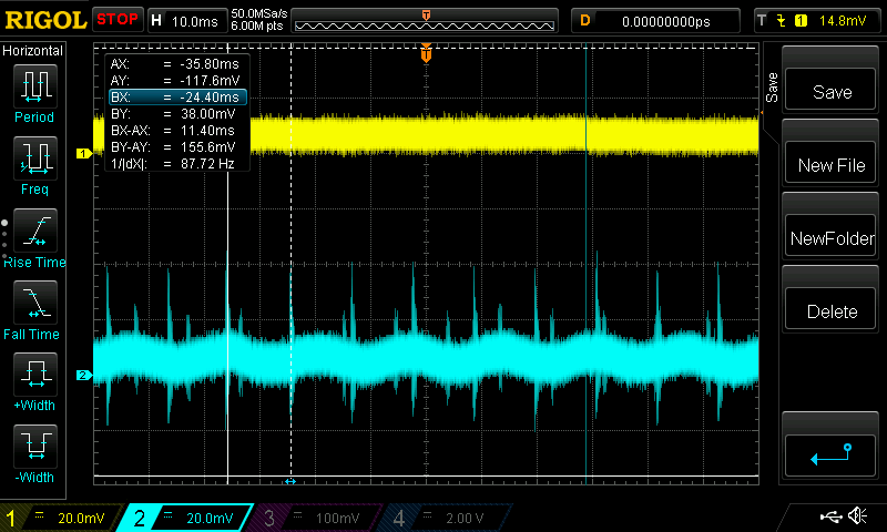

Here is my latest oscilloscope trace showing some output spikes which are likely the source of the noise I'm hearing. It sounds kind of like white noise but different. Now it appears I've gotten rid of noise on the input stage, this noise is only showing up on the output:
NOTE: The Yellow trace is the Input signal and the Blue trace is the Output signal.

Here is another look at this noise with a different time base. In this case there are no effects in use, the code is simply reading the ADC and then putting the same value to the output. At this time scale you can see the spikes are occurring at a rate of 44.6KHz and only on the output. (hard to see but there are spikes under the vertical cursors).

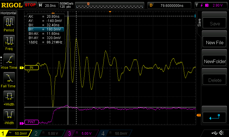

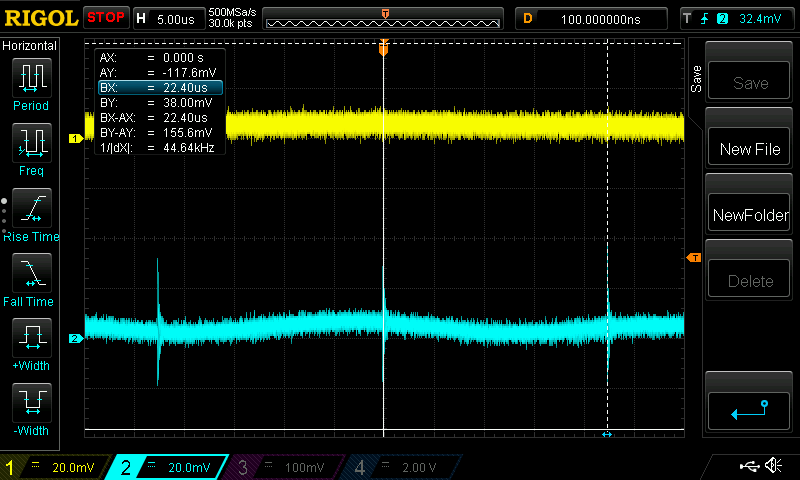

I just found the source of the noise spikes I'm getting in my audio signal output. The PWM's used to produce the output signal introduce a ~50mV ringing spike whenever they transition from either LOW to HIGH or HIGH to LOW. In the scope captures below I'm looking at the PWM signals coming out of the MCU (before any filtering) and it's pretty obvious that this is what's causing the ringing spikes in the output. The PWM signals switch between 0 and 5v and share the same ground as everything else in the circuit. There is only 1 power source in use (the Arduino's regulated 5V output).
I just looked at the 5V coming from the Arduino's regulator and it's showing a ~200mV spike whenever the PWM's transition as well. I'm going to try adding a capacitor from 5V to ground and see if I can clean up the 5V going into the circuit. In a digital circuit a ~200mV variance of the 5V supply is typically nothing to worry about but in this audio circuit it seems to be very significant.

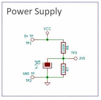

I can add a Cap or two to the 5V supply. If you'll notice on the schematic there is already a 100nF ceramic on Vcc of the OpAmp. Also, the 2.5v power source (from a voltage divider) has a 4.7uF electrolytic. The OpAmp is currently the only device being powered by the 5V source.

In this case I'm using the PWM in Phase Mode with an ADC sample rate of 31KHz. The voltage spikes are occurring on every transition of the PWM's output not when the PWM registers are being updated.

Is there any way to calculate the best capacitor to use given the measured spike characteristics? I would just try various values of capacitors across the 5v supply and Ground and see where the sweet spot is but since this is going to involve soldering them in place I want to make the best guess possible before I heat up my soldering iron.
The 5V supply already has a 47uF (on the Arduino) and a 100nF next to the OpAmp. What would be the best value to add?

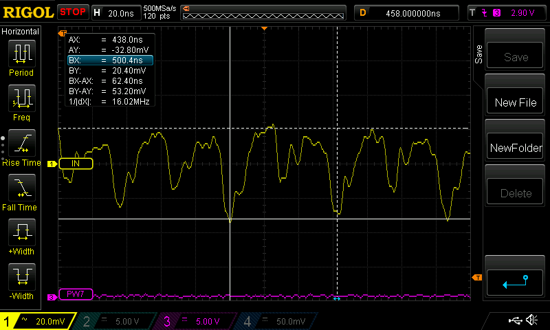

Apart from the PWM spikes above, the 5V supply looks pretty noisy when it's not spiking. The 16MHz clock is causing the 5V supply to swing by 53mV. At this frequency however, I'm not sure how significant this is to my Audio circuit.

The main issue I'm having with noise is the spike that occurs when the PWM's change state. This causes a spike in the audio output that is several times the magnitude of the output waveform. If I can get this PWM transition spike taken care of I think I'll be pretty happy with the Audio from this Low-Fi effects processor. (i.e. I'm not expecting exceptional sound quality)
Assuming the former alone, you might try using the logic output from the port to drive an NPN transistor. The pullup resistor can come from a highly filtered voltage source. To get that filtered source, a small inductor in series with a resistor and two filter caps (one ceramic and one electro) and that should be able to clean up the power supply noise.
I don't think the issue is with the PWM output itself, these signals are 0 to 5v and look pretty clean. The issue is that when the MCU changes the output of a digital PIN it causes a voltage surge (or dip) in the Vcc Voltage which then biases the OpAmp inputs and supply voltage. This bias gets amplified and sent to the ADC.

The next thing I'm going to try is adding a RLC filter to the Vcc 5v input of the Circuit. I've tried using several values of capacitors from 5V to Ground and none had any effect but they were 10cm away on a breadboard which I'm sure the distance involved has an effect.
I'm beginning to suspect that this voltage spike is a Ground loop issue. If I connect a scope probe to ground only and leave the tip disconnected I can see the spike and it has a pretty large magnitude. Although, I'm not so sure, if I measure the resistance between all ground points I get the same value.
