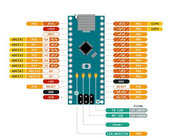

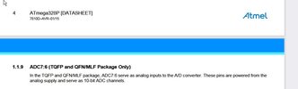

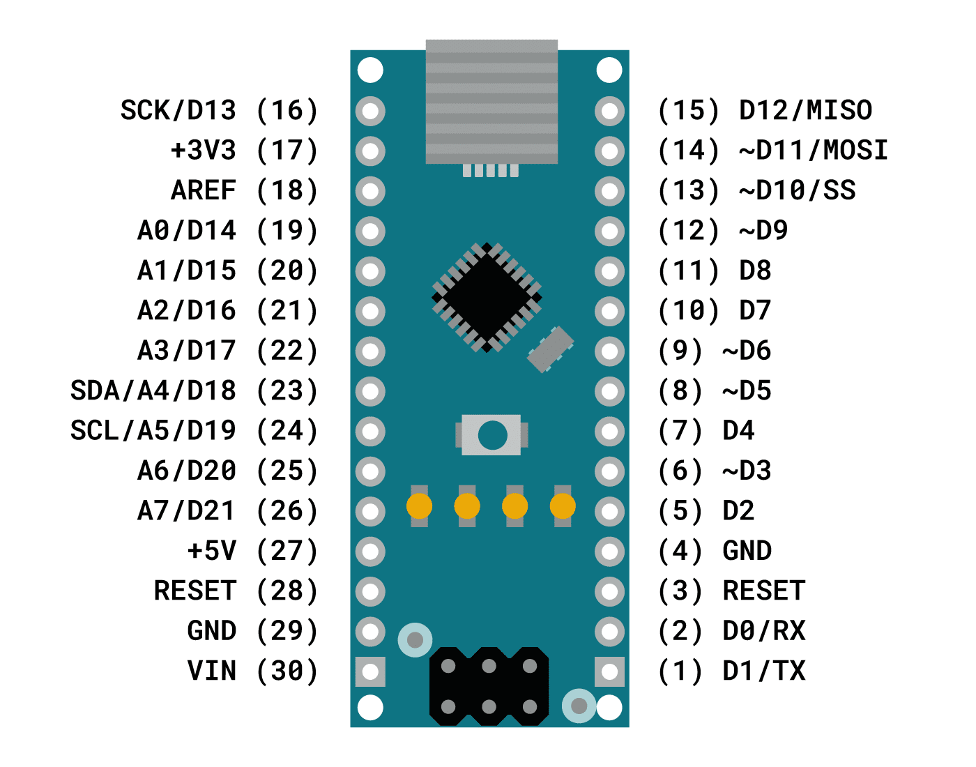

Its because on the Nano, pins A6 and A7 are Analogue Inputs only, not Digital 20 & 21 -see pin out diagram

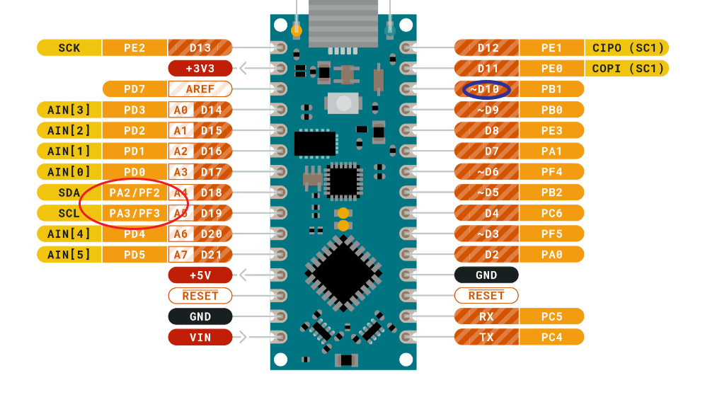

The pinout the poster lists seems to be the Nano Every (or similar), not the "regular" Nano
I didn't know there was such a beast.

Any idea what they mean by PA2/PF2 etc? - red eclipse.
And what does the tilde mean on some of the digital pins? I.E. ~D10 - blue eclipse
They seem to have used UART1 for the default as that can be remapped to PC4 & 5.
UART0 defaults to PA0 & 1 so it might be possible to use it.

Pommie, the tilde denotes a PWM port, I think. Seems there are only 5 of them.
BTW, one uart handles the USB traffic, and the TX/RX pins (D0/D1) are the "other" USART. That implies one can use both at the same time?

Those pins show up over here on chip pinout, basically analog pins :
