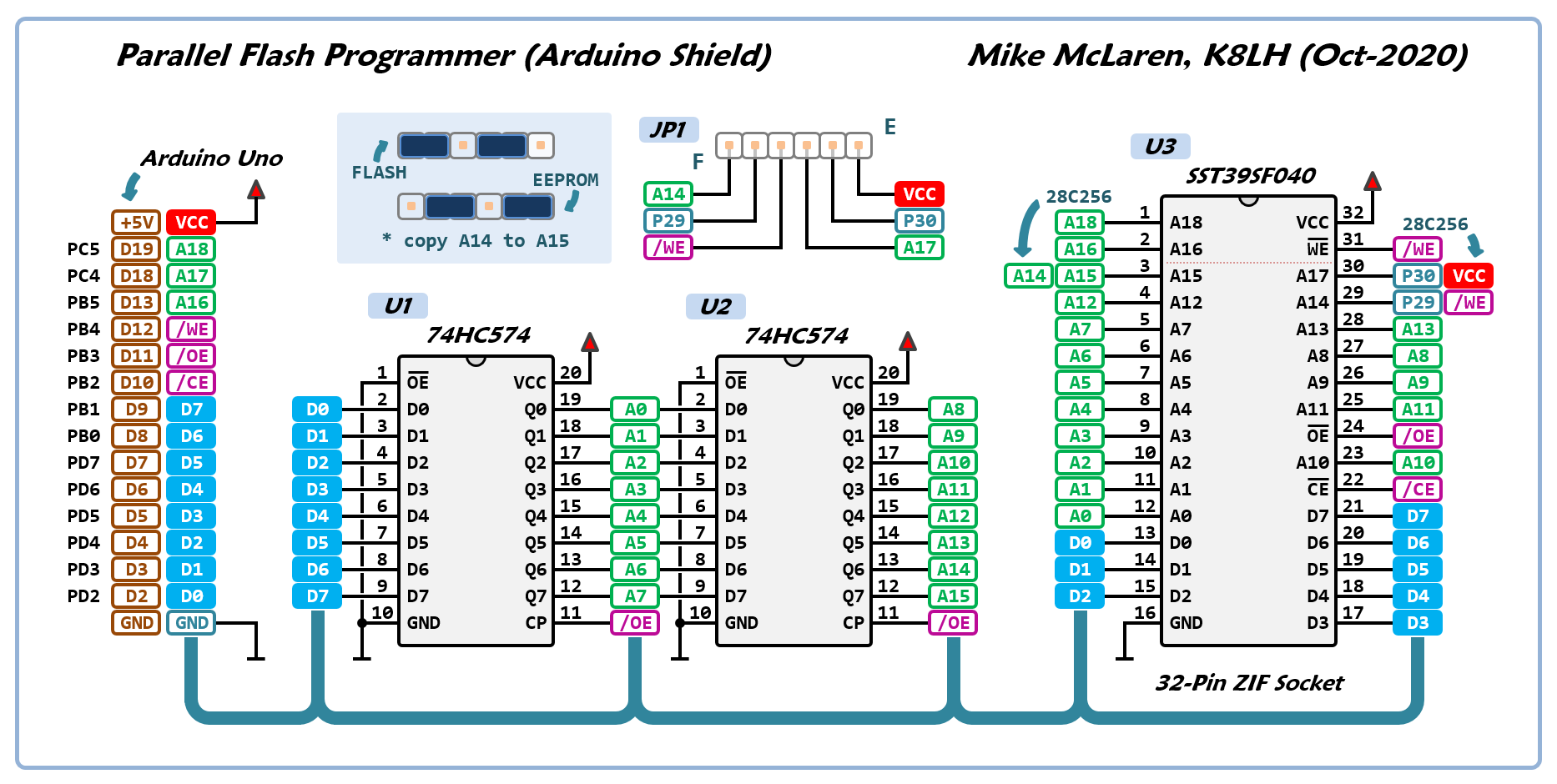

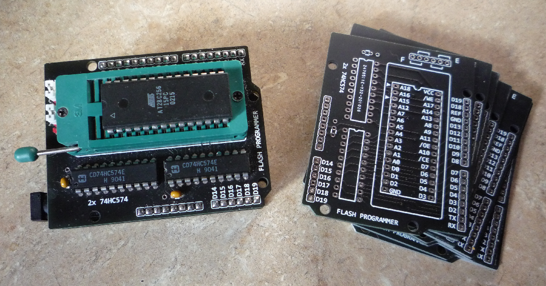

Hi guys. I'm trying to copy a bit in a local variable to another bit position within that variable but so far "no joy". Basically I'm trying to copy bit 6 in the "hi" variable to bit 7 but none of the instructions I've tried are recognized by the compiler (the size of the compiled program doesn't change and there are no error messages). Please help?
TIA... Cheerful regards, Mike

   uint32_t address = 0x0100;
   const char hex[] = "0123456789abcdef";
   void setAddr(uint32_t addr)  // hard coded for 28C256
   { byte hi = (addr >> 8) & 0x7F;  // A14..A8 bits
     byte lo = addr & 0xFF;
   *  set data bus lines to outputs
     DDRB |= 0x03;              // PB1..PB0 (D7..D6) Outputs    ( 6)
     DDRD |= 0xFC;              // PD7..PD2 (D5..D0) Outputs    ( 6)
   *  strobe latches with address hi (A15..A8)
     if(hi >= 64) { hi |= 0x80; }                <------------------------------
     PORTB = (PORTB & 0xFC) | (hi >> 6);
     PORTD = (PORTD & 0x03) | (hi << 2);
     cbi(PORTB, OE);            // OE(PB3) = 0                  ( 2)
     sbi(PORTB, OE);            // OE(PB3) = 1                  ( 2)
