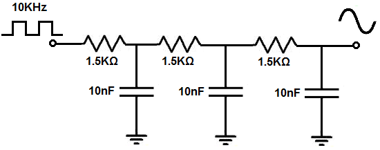

I would like my arduino to sound an alert. To do this, I cobbled together the following:
tone (8, 500, 500);
It is not very loud. (The resistor is 100 ohms.)

The first circuit, with just a speaker and 100 ohm will be very low power, the second should be considerably louder, but you may have killed the transistor as it's not suitable for feeding a low impedance loudspeaker. Note that the ciruit shows a buzzer, not a loudspeaker.

Also, I wonder if it may sound better if I converted the square wave the tone() function generates to a sine wave.
I will look for a circuit for that, too.
It will give a roughly sinusoidal signal, but at too small an amplitude, so would need an amplifier. Also 10kHz is arguably too high a frequency for an alert tone.
The alert tone will most likely be about 500. (I do not think we can hear 10K can we?)
Do you think the sine wave might be a bit more pleasing to listen to?

10K should be easily audible for most people, standard hearing when young is about 20Hz to 20KHz.
However, it's far too high for such a use, 500Hz to 1000Hz would be alot more suitable.
A sine wave is certainly 'nicer' than a square wave to listen to - but you would need a proper amplifier - you mentioned Arduino amplifiers, there are endless cheap examples of those you can buy.
