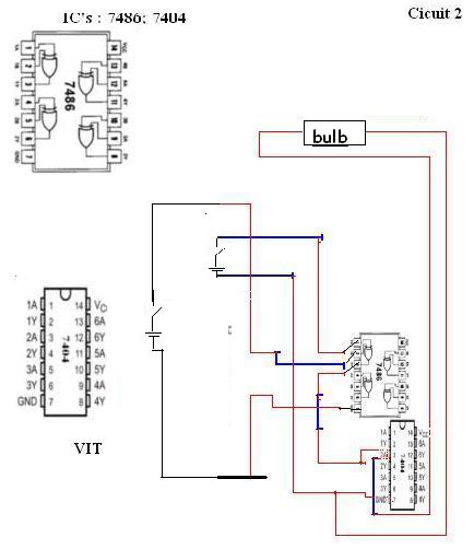

Input & Output (Circuit should be complete?)
Is this Circuit Correct? (Basic Switching circuit)
Blue Lines indicate, wires without connections in between.
BAT, Switches are represented in Diag.

what EXACTLY are you wanting to do??
for one thing if you connect the circuit as pictured, you will smoke the 7404 as it won't drive an incandescent bulb unless it draws less than 20ma.
we need more info on what your attempting to do.

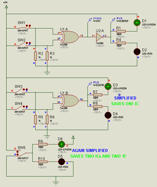

According to the logic of an XOR-gate (7486) the output of that is only high if one input is high and the other low. If both inputs are low or high the output will be low.
Since you are not switching any pin to low that circuit won't work at all up to that point.
Connecting an inverter (7404) to the output of the XOR that one won't have to switch anything since you always have one input of the 7486 floating.
Connecting either a SPDT or pulldown resistors (use 470Ω for TTL logic and 10K for CMOS logic ICs) at the inputs of the 7486 the inputs always have defined state.
Anyway, connecting an inverter to the output of an XOR makes no logical sense to me.
TTL-ICs normally have a fanout of 10, but they won't drive a filament type lamp.
To speak similar to the other post you'll have the impression being surrounded by Indians when connecting a lamp to the IC. :D
Logic ICs only do the logic work. For the power stages you must direct the output of the logic into a an appropriate power stage.
Here is your intended circuit with two "improvements". :)
