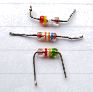

I am trying to find what the physical apperance of a diode is to a resistor. My understanding is that they both have colored bands on them, so how would I be able to tell which is which just by looking at them.
Any help is greatly appreciated.
Diodes almost never have color bands.

...but some do!
Generally, though, a diode has only one stripe; a black stripe at the cathode end.

Thank you Alec and Ron,
Alec the pic of the diodes you posted look like some on the circuit board I have execpt with just the one stripe on the cathode side. Since they are glass and I can see the connecting wire inside I thought they were in-line fuses.

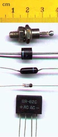

As you seem to be discovering, diodes generally speaking come in two flavors:
1. A small glass package (small signal diodes like the 1N4148 and small zeners), which has a single stripe indicating the cathode end.
2. A black plastic package, also with a stripe (generally white) indicating cathode.
Of course, diodes come in all sorts of weird packages, including ones that look like "flat-pack" resistors, DIPs, etc. But most are like the two styles above.

I have also found some rectifiers that are black plastic rectangle package approx. 1"x2" that house serveral diodes.
Those are probably bridge rectifiers (4 diodes in a package), with 4 connections. Package is probably marked "~ + - ~" (outer pins are AC, inner DC).
Yes, that is exactly what the marking are. There are 4 of them through out the PCB, 2 of them have a small red dot on one end of the pakage. So, these would change AC current to DC current?
