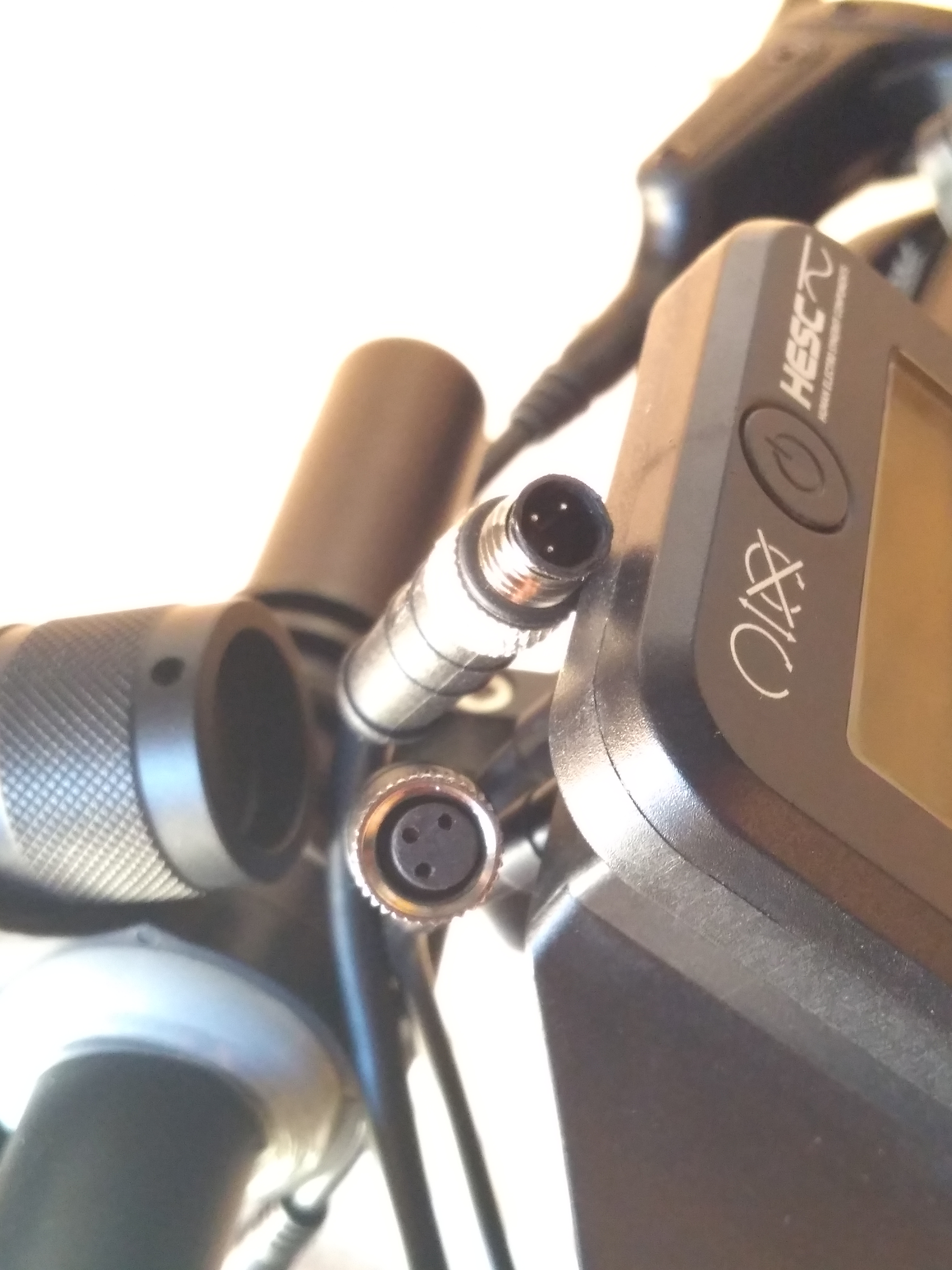

Halfords e-bike Carrera charging plug and socket.
May be Chinese SUNtours, but I need to but them and solder cables to them myself.
The plug is 8mm wide at the threads..

They look rather like a 3 pin version of an 12mm / M12 sensor connector.
eg.
What is the outside diameter of the thread?
Either that or some variety of screw-locking DIN connector? Though all the ones I've seen have a fine thread in a different area, more like this:
Outside diameters is 8mm as mentioned in my first post.
Thank you.

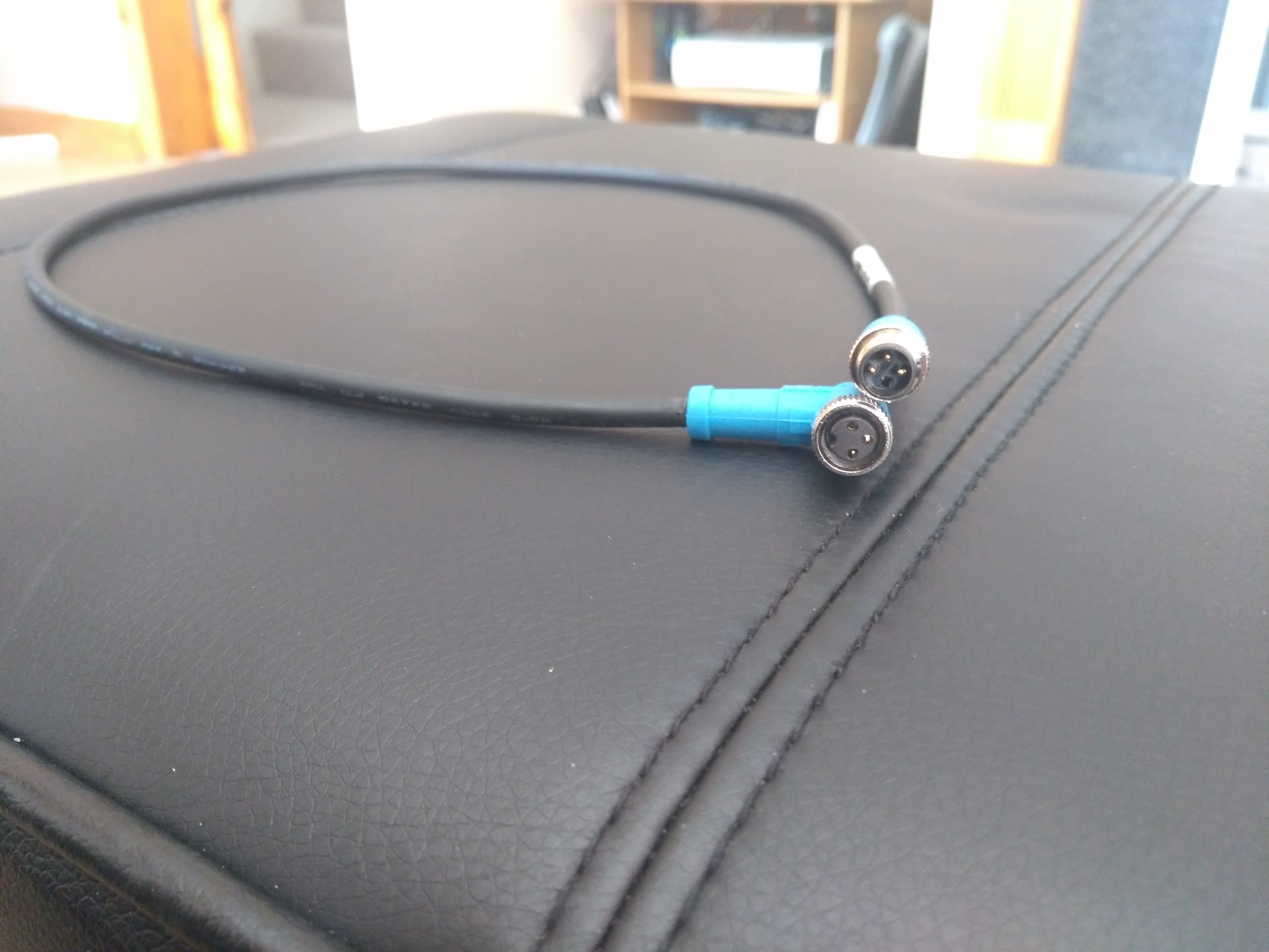

Ok guys,
Here's what I bought from RS components. UK.rs-online.com
A 50cm extension lead for the charger cable.
RS code: 1860356
Desc: RPC-M8-3MS-0.5-M8-3FR-PVC
Thanks for your help.
