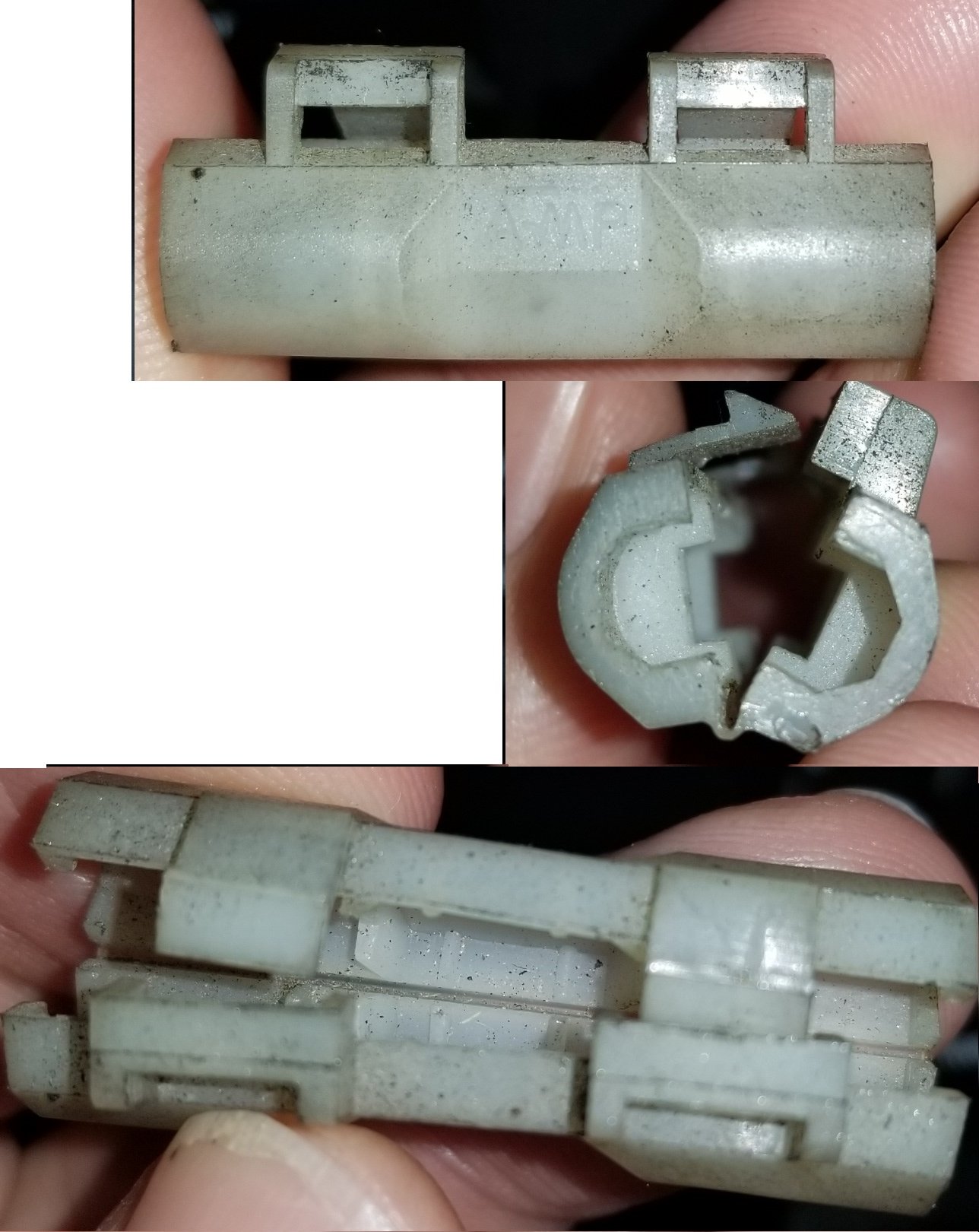

Anyone know what this connection cover is called?
LSBoss
I need a few of these. It says "AMP" on it, no numbers or any other marking. It was used to cover the connection between 2 non insulated single wire spade connections (male to female). It's 1.5 inches long, and when closed maybe .5 inches in diameter; white and plastic (or nylon or similar material).
Anyone know? I've been googling for hours and can't locate it.

"Insulating Sleeve Natural Faston"
These, in other words: https://uk.rs-online.com/web/p/crimp-terminal-covers/7188198/
AMP is now part of TE Connectivity, but the data sheet for those dates from 1970 and shows that exact thing with the AMP logo..
https://docs-emea.rs-online.com/webdocs/0f91/0900766b80f915b0.pdf
RS seems to be the only place that has them in stock. Mouser & Digikey etc. list them but zero available.
