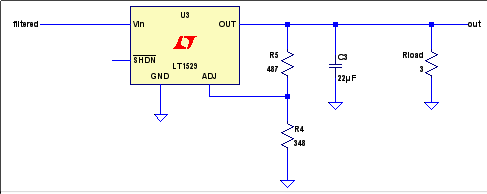

The simulator doesn't care what the output it; it's just whatever you decide to use as the output. I've attached an example to show you how I've done it. Note that I only think this is correct; seems to be to me. I'm sure I'll be corrected if not. :)
Oh yes: you can name wires (nodes) by pressing F4 and typing in a name, then placing the name on the wires as if you were adding any other component. Then when you run the simulation and select that node to trace it will be called (i.e.) 'V(out)' instead of something non-descriptive like 'V(004)'.

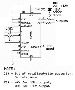

There are many ways to make a square-wave oscillatior. These two circuits use digital inverters or gates plus many resistors and capacitors.
A CD4047 IC is an RC oscillator plus a digital divider. It has two outputs that have "perfect" 50-50 duty-cycle square-waves that are 180 degrees apart and are perfect for driving two N-channel Mosfets that drive a center-tapped transformer. It uses a single resistor and a single capacitor.
The center-tap is connected to +12V and each opposing end connects to the drain of a power Mosfet or the collector of an old power transistor. The Mosfets or transistors are driven to ground in opposition which creates a high current square-wave in the transformer.
The transformer without a center-tap needs push-pull drivers at each end of the winding so that AC flows. One wire is driven to +12V while the other wire is driven to 0V, then they reverse.

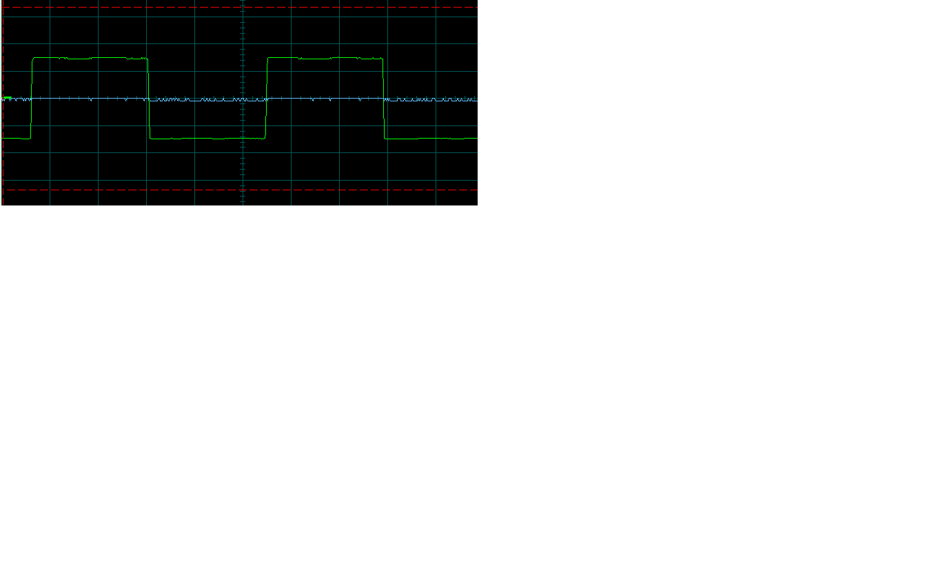

I made this circuit but I faced an strange problem. I am not able to see 180 degree of phase shift between pins 10 and 11 of 4047! both are the same when I look then by my scop! My scop is a one channel and I just see the below square wave but not to be inverted in the other pin (both are at the same place/position while I do not change anything on the scop)!! It is very strange.

The datasheet for the CD4047 says that its has a true output and a complement output.
They are 180 degrees from each other. When one goes high then the other goes low.
You must use a dual beam 'scope to see it.
