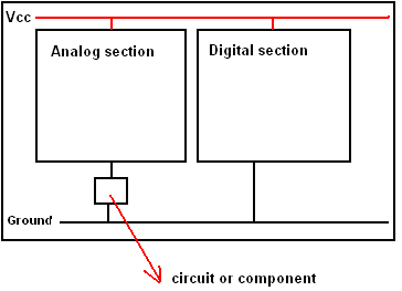

Eplanet said:
is there any component that can separate these Grounds?
Yes, it's called a PCB - they BOTH have to be joined together, because they are the same thing - but they are listed seperately so you can design your PCB to prevent the digital noise entering the analogue side via currents in the ground connections.

Ground Tale
hello all
what do you thinking about this attachment for more clearly?
is there any circuit or component that before connecting Ground to analog section that can preventing digital noise to analog section?
