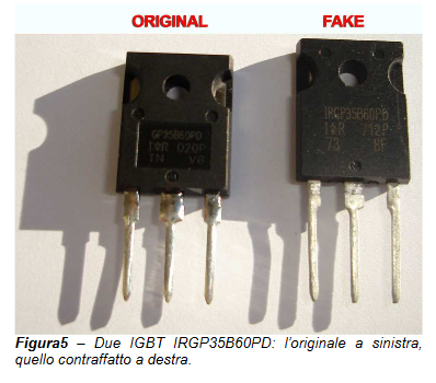

I appreciate your time , but just one question ; how to tell the difference between a fake IGBT and good one even from a usa or uk distrubitor ?
for example hgtg30n60a4
I see .
You can't always tell fakes. The only way you can get a feel for it is by reading the exposures on the net and by experience. You could test the parameters but for many devices that would be a lengthy and complex task requiring specialist test equipment. But even if the device passes all of its parametric tests you will have no idea about reliability. Proper manufacturers spend a lot of money to make sure that their components are reliable and electronic devices, especially semiconductors, are made to incredibly tight tolerances.
As we have said, only buy from mainline distributors for your critical components, especially IGBTs, which are relatively expensive and thus worth while counterfeiting.
Even something as basic as resistors can be substandard. There have been quite a few cases where people have bought a batch of 1% resistors only to find that they are as much as 10% out.

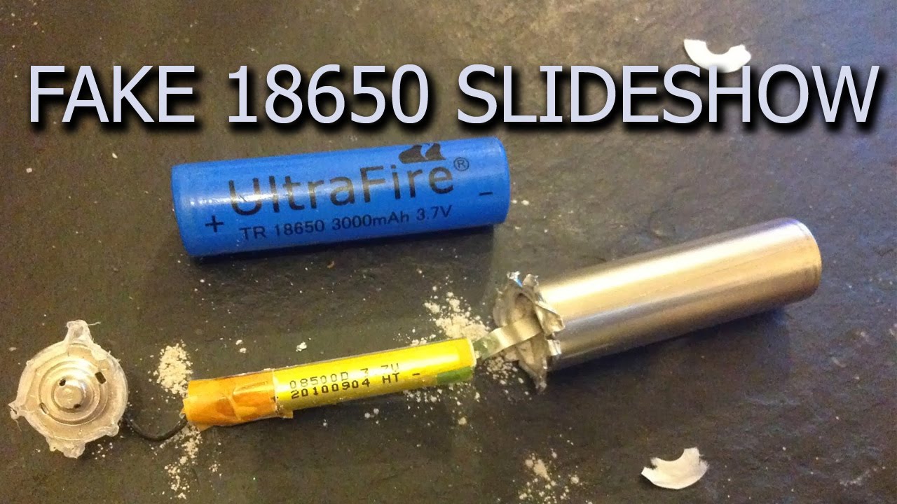

The number one rip off items are batteries- the net is full of them and even your local store sells them.
The irony of it is that if you buy wisely you can often get components from the main line distributors at prices not much more than the counterfeit stuff. If you are a volume used the best bet is to get a trade account.
