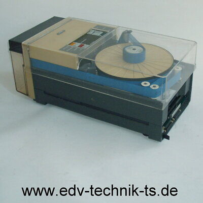

I need something along the lines of one of these, a computer data tape punch, but hopefully at a much less ludicrous price!
I have a GNT4601 but that cannot handle the tougher mylar laminated tape, only plain paper.
