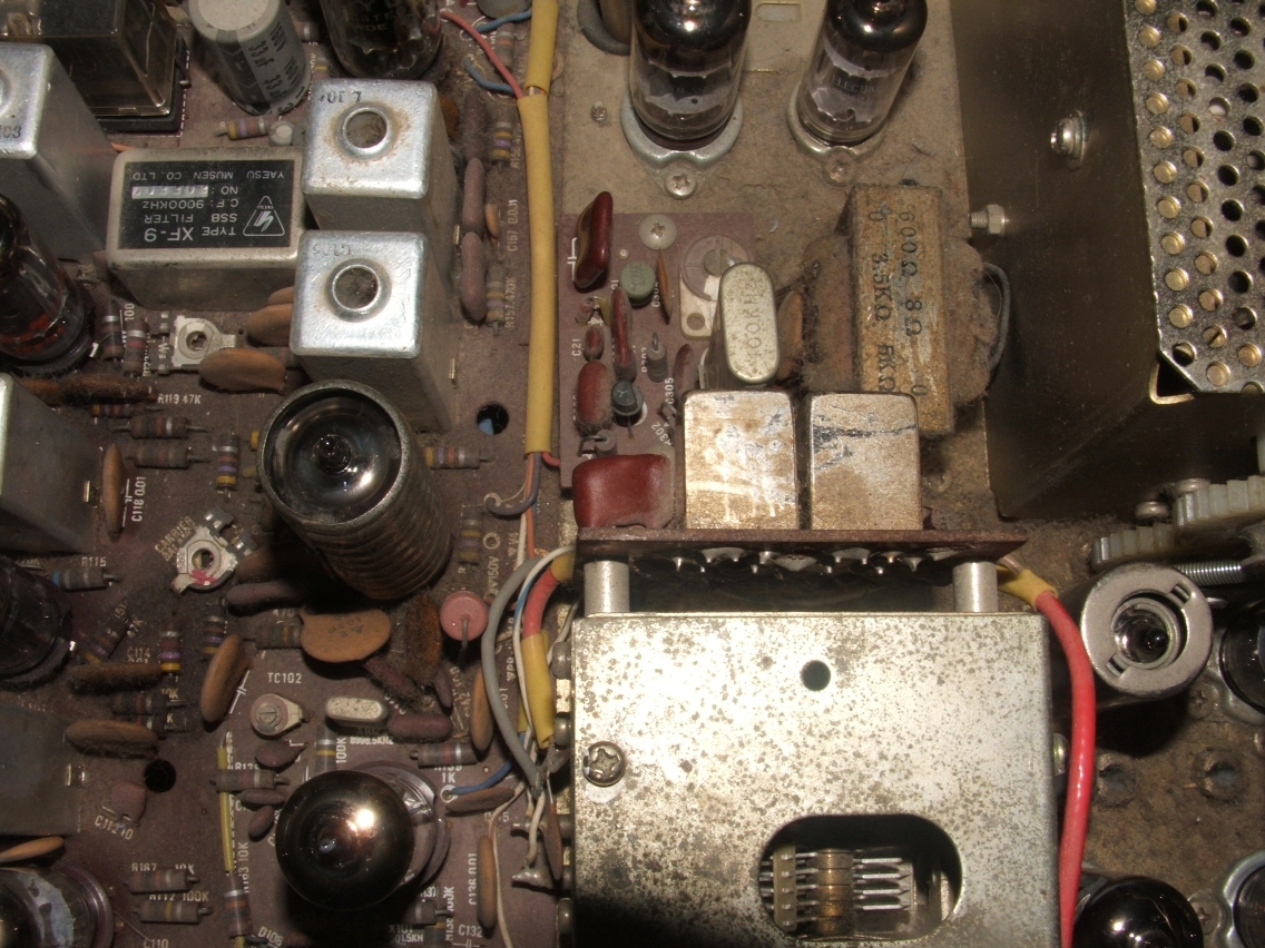

Anyone have any ideas how I could clean out the inside of my radio?
Andy1845c
Active Member
Sounds like an odd question I know...... I have a transformer that looks like a wooly mammoth and capacitors that look like they are growing beards.:(
Take a look at the attached picture. The dust looks like it would blow out with canned air, but it won't. Its caught in kind of a gooey layer. I am not sure what exactly it is, but its almost like kitchen grease in texture.
I'd kinda like to clean it out. Is there anything I could spray on it with out risking damage to the older components in this 30 year old radio? Possibly somthing I could spray along with blowing on it with compressed air to aid in flushing the gunk off the boards?

Isopropyl Alcohol? It's conductive though...so make sure it's dry.
I was thinking maybe that would work, but wanted some opinions. I would want 100% isopropyl alcohol, correct? I think common rubbing alcohol is part water.
I use an industrial grade of spray-on electrical contact cleaner.
It is more expensive than alcohol ... $8-10/can.
However, it will completely evaporate ... no residue.
A large bag of industrial, wood stick type, cotton swabs will probably come in handy.
Also suggest a can or two of the compressed air spray .....
Be very careful with electrical contact cleaners as they can destroy certain plastics. 100% isopropyl alcohol is a good choice. Be sure to remove components that can trap liquids, like the relay in the upper left hand corner of the picture, before bathing your radio in any cleaner. Personally, unless I was going to display this radio in a museum or something, I would just clean it with a soft brush and not use any liquids.
Yes, i mean 99.99% Isoropyl Alcohol- the kind in electronic stores, not the kind in drugstores (although I found it once there for really cheap...they don't seem to carry it anymore).

I agree, if you have dust accumulation. First blow it out with some high pressured air then follow up with something that is not going to damage any plastic. Maybe even brushing with the air or something. Were a mask you never now what's in the dust accumulation.
kv
My first reaction is to support kchriste's recommendation. If it ain't broke, don't fix it. Brush it and vacuum it and let it be. Actually, despite the fact that I've used a mil surplus dental compressor with regenerative dessicant dryer for cleaning things for many years, you are better off using a 1" paintbrush with a vacuum equipped with a narrow sofa cushion wand, rather than compressed air. Less chance of driving dust and grit into places you don't want it like between the variable capacitor plates or into the exposed, greased ball bearings of the capacitor rotor.
My second reaction is to not use any solvents like alcohol. Decades ago, when Tektronix still made tube-type oscilloscopes (and when it was a unique company with very helpful field reps and tech support), they issued an application note on cleaning old tube-type oscilloscopes. They strongly recommended against any solvents and recommended instead a water bath with detergent! I've used that approach many times over the decades with good success.
The procedure is to protect all parts that could be damaged by water, including transformers and cardboard casings on capacitors by removal or by covering with plastic baggies, shower the instrument with detergent solution, brush gently with a paintbrush to loosen crap, rinse with tap water, RINSE FINALLY WITH DISTILLED WATER (not de-ionized water), and dry in a well-controlled oven for a LONG time at very low heat. If it is uncomfortable to put your hand on the instrument for a long time it is too hot. That's about 140 degrees F. The distilled water will leave no residue or minerals as can tap water.
Once the cardboard capacitor casings are protected or removed, the instruments are not very sensitive to water. Oh, yeah. Remove any speakers.
One big advantage is that detergent solution is less likely to remove identifying marks from components although it CAN remove identifying numbers from some tubes, so always write down the tube types and their locations. It is actually best to remove the tubes one at a time, write down their type and location in the instrument, clean them individually and put them aside in a manner that preserves their information.
Detergent solution is also much more environmentally benign and harmless to you than solvents and is available in large quantities for pennies rather than in 1/2 pints for dollars. You can use it liberally without concern. Tektronix recommended a lab glassware cleaning detergent, probably because it would rense easily and not leave a residue. I have used detergents from home supply houses like HD with success.
Solvents will effectively remove grease from the ball bearings on variable capacitors. That's not good. Mild detergent is less likely to remove the grease unless you focus your brushing on it. In either case, regrease the bearings after any cleaning procedure.

whatever method you use, take detailed pictures and write down identifying marks before cleaning with solvents of any type.
Transformers aren't uniquely sensitive to water but they can get saturated with water within the windings and they can be difficult to rinse effectively and to dry out. That's one reason to continue the drying under gentle heat for much longer than you think is necessary by surface inspection. It's better to avoid saturating transformers with a baggie.

hi Andy,
If the radio is working, IMO dont attempt to clean it.
You will most likely create faults, the maxim is, 'if its working, leave it alone'.
If you must clean the transformer DONT use chemicals, especially Isopropyl Alcohol.
Use a soft 1 inch paint brush and a hoover/vacuum extension, very lightly brush the txr while extracting the dust.. dont disturb any wiring...
Scruffy little sucker isn't it!
My approach, (based on having done it several times before), to cleaning this would be:
1 Use a soft brush (1" paint brush) and a vacuum cleaner. Brush the dust and use the vacuum to suck away the displaced dust.
Compressed air is a bad idea, just spreads the dust around the place.
2 If the dust is stuck on, use the brush and either isopropyl alcohol, or, water with a trace of detergent.
Allow the clean unit to dry for several days before applying power.
3 Take care not to get water into the coil screening cans, it will take for ever to dry out.
Also, dont let the dust get into the variable capacitor vanes.
4 Don't use "contact cleaner" sprays, they just leave a sticky mess and will hold more dust.

I second the water approaches. One little addition: adding a little alcohol to the water will improve its ability to get through smoke and oily residues. In other words, adding isopropyl alcohol will act like a surfactant ("detergent") and will not need to be rinsed.

Excellent cleaning advice, awright. That's the approach I would recommend, OP.
In 1982 I had a job that required maintaining all the old Yellow Cab taxi radios in Oakland, Ca. and adjoining area. These were all tube radios designed in the early 1960s, I think.
When they came in to the shop they were dirty and had cigarettes, pills, gum, you name it in them :)
We cleaned them and then repaired them. They were shiny after cleaning. Here is how we did it. Make a mix of 1/3 water, 1/3 ammonia, 1/3 "Formula 409 Bathroom Cleaner" in a large plastic (as I remember) bucket. Remove the speaker from the radio and immerse the radio in the mixture for a few hours. Remove and wash with water. Let dry in the sun. Retune the radio.
