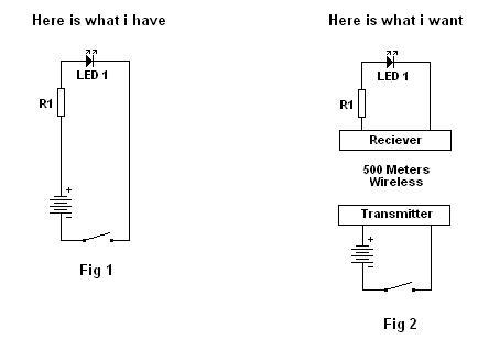

HI there everyone, Ok im not sure where to start with this project so here i am again asking stupid questions. i dont want this circuit to be over complex just as simple as i can make it would suit me fine.

Ain't going to happen. Transmitting even a few mW to a receiver 500 meters away would require a radio transmitter of tremendous power which is hardly safe, efficient, cheap, or legal. There are ways tightly directed microwaves can certainly transmit enough power over 500 meters but it's not practical for what you're doing, it's an expensive and very technical task.
:roll: :( ok so what would the maximum range be if 500 meters is too much i may be able to get away with 80 meters if i move the reciever.
i don't think it is possible to transmit power even a metre. unless your reciver has a battery
:roll: ok ok.. I land on a beach or shore in my boat, the boat compound perimiter is 60-80 meters away, the compound is about 300 meters long, at the back of the compound (approx 380 meters from the shore) is the winch shed, in the winch shed is the boatman the winch is a very old large noisy lister engine (cant use walkie talkie), i would like to push a button on a device on my boat that turns off a red light, and turns on a green light in the winch shed, this will tell the now deaf boatman that the winch cable is connected to my boat and it is safe to start the winch, when the boat is far enough up the beach or if there is an accident i would like to press the same button to turn off the green light and turn on the red light telling the boat man to stop the winch... i was trying to avoid explaining that as typing with a broken hand is not easy :roll: :wink:

Ricardoco, your wordy explanation is much more helpful that the original sketch and describes the problem fully.
I dont think the solution to your problem is "simple", however, you say that a walky talky does not work due to the noise of the winch engine. Have you considered the possibility of connecting to the radio a more powerfull audio amplifier and a larger loudspeaker which can be heared above the engine noise. ( I am assuming here that the radios are available).

Yes JimB you got it. The radio is the way it is done at the moment and it is very loud but as my hand proves it is not an effective way of communicating the word STOP!. from the post so far it seems that distance to the boat shed is a problem, well i have looked and an antenna put on the fence at the edge of the compound would be do-able so the distance from reciever to transmitter would be around 80 meters max. Would this make it easier?

Look at Maplin, they have a range of licence free radio modules and complete assemblies (key fob type transmitters etc.), it would be easy to do what you want.

May i also suggest that any sort of signal to operate the proposed
lights, would be to sustain the 'Off' condition of the red light
when in use, so that a failure would bring up the red light.
I think a simple RF setup could be easily made. I don't think it
would need to be very powerful, i guess both ends have a supply
available. Reliability would be more important. The use of lights as
you describe sounds simple and effective to me.
