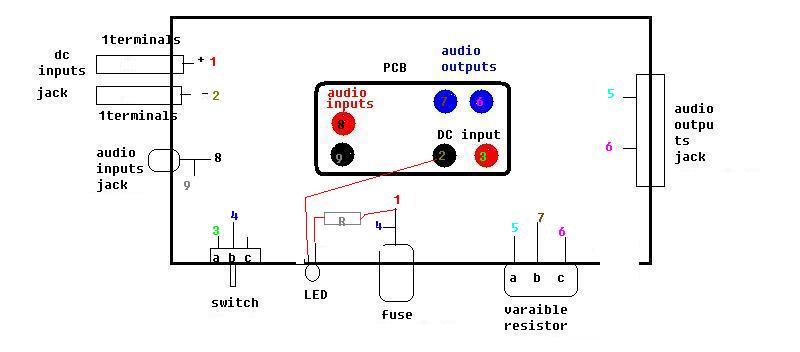

any one can help on the amplifier circuit? (images)
kuangmao
i am so sorry.....i forgot to draw the audio input jack.....

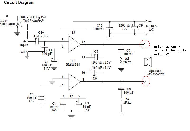

this is an audio amp.

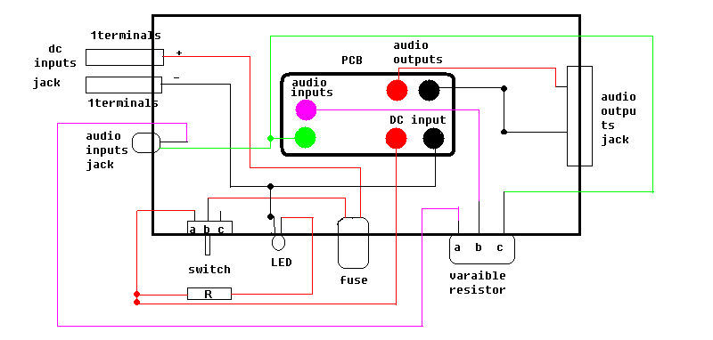

1234.JPG i connected likethis
Yes, both are wrong.
Your picture is very unreadable.
As far I can see it is powered by a DC source.
Draw it again without the connections and name the terminals so that I can help you.
If the variabler resistor is supposed to be a volume control then it should adjust the level of the input, not the power supply DC voltage.
I think you did not get what I have said to you, kuang.

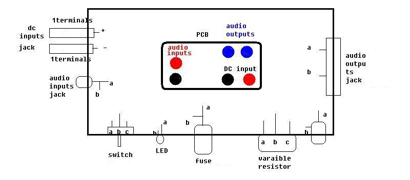

I'll name the terminals.
Switch -> Has 3 terminals. A, B, C. From Left to Right.
Potentiometer-> A,B,C. From Left to Right.
DC + jack -> Fuse -> Switch B.
Switch A -> DC + Input.
DC - jack -> DC - Input.
Audio + Jack -> Potentiometer A terminal.
Audio - Jack -> Potentiometer C terminal and Audio - input.
Potentiometer B -> Audio + input.
Led: You'll have to add a 1.2k resistor:
Switch A --- 1.2k resistor ---- Anode
Cathode--- DC -
Look at the led base. Cathode is the flat spot.
